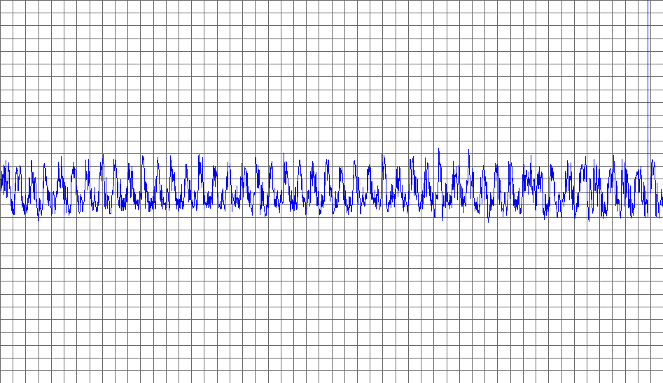

We're experiencing an issue with the Channel 3 output (V1, WCT) on the ADS1293 showing a distortion of the signals. Leads I and II from CH1, CH2 are working fine, but we're seeing the below distortion on Channel 3. This is with a test input 10Hz sine wave on inputs IN1...3, 5. CH1, CH2 show normal sine waves.

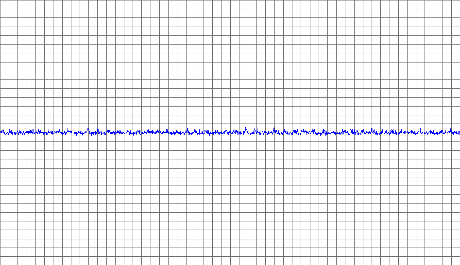

If we short all inputs, CH1 and CH2 are zeroed out but we see this on CH3.
So the distortion in the first screenshot is the sine + interfering signal in the second. Those pulses appear to show roughly every 4.5Hz on the distorted signal. We are using the reference firmware taken in the heartrate example, no modification was done to the register settings as we used the Flash Programmer to directly program the board with the hex file from the project to evaluate the chip. But below are the register settings for the ADS1293 taken from the project. Any idea on what could be causing this?

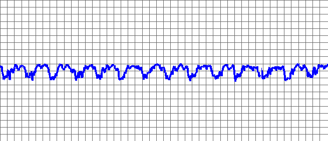

    I shorted the WCT pin on my PCB to the inputs - all channels are zeroed out except the V channel is showing this:
    If I short WCT to the inputs but leave RL open I receive the following on ALL channels:

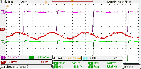

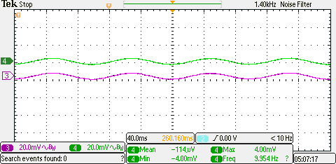

    Multiple boards are showing the same. I probed the inputs and WCT with a scope (connected from a simulator), nothing looked unusual.
    (below using input sine 4mV 10Hz signals)
    (pink signal is V with respect to ground, green is WCT with respect to ground, red is the difference done by the scope math function)
    (green signals is LL with respect to RA, pink signals is V with respect to WCT)

    Could the problem be due to a filtering issue done in the ADS?
  • Hi Hussam,
    There is no filtering in the ADS1293 so that may be the problem. Some systems use analog high-pass filtering and a low resolution ADC. The ADS1293 has a DC coupled signal path and a high resolution ADC. The software behind the ADS1293 in the micro needs to remove the low frequency components. If you write some code to implement a high-pass filter on the data from the ADS1293 that may be the best way to remove it.
    Mike
