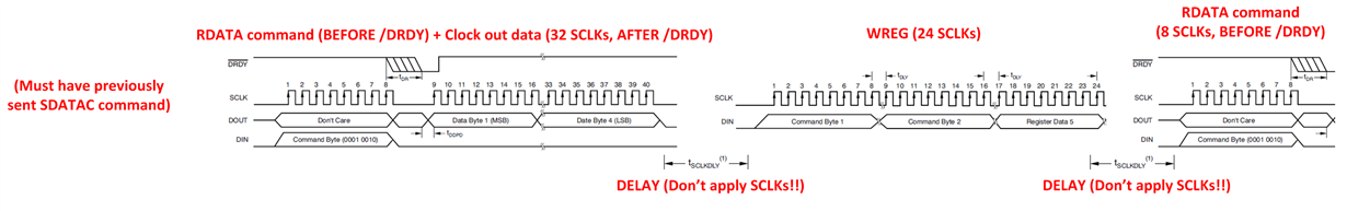

I plan to use "Read data by command" as we need to change the input channel alternatively. I have attached the timing diagram for this application below.
I am trying to change the input Mux setting and issue RDATA before reading the data on DOUT in order to reduce the sample to sample delay. Is this sequence possible? Is it also possible to read out DOUT at the same time write to the device on DIN as DIN and DOUT are separate pins from the DSP? This will ensure that the read and config operation happens in parallel. The above scheme assumes that the "tdr" time is 1/Fdata rate which is given as the maximum value. What would be the minimum time after issuing RDATA and the DRDY going low?
If the above scheme is not possible (RDATA command before reading data), can we read the data first and then issue the RDATA command?
Is there a better solution for this?

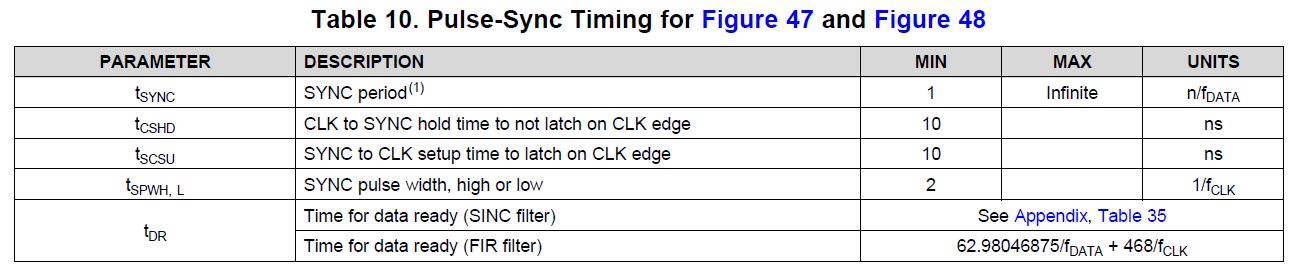

    Refer to tDR in table 10:
    At 16 kSPS, the time to data ready will be about 408 us. That leaves ~92 us to read the data and switch the MUX. Since this operation requires about 64 SCLKs, SCLK will need to be around 1 MHz to meet this timing requirement...going to 32 kSPS, will allow more time for this operation and allow for a slower SCLK frequency.
    Regarding the command sequence, the data must be read before writing to the device registers.
    The ADS1282 resets the digital filter and restarts conversions after writing to the device registers - it does not preserve the last conversion result.
    Chris

    A few comments:
    • The data read out is 32-bits (without a /CS, the readback cannot be truncated).
    • Do NOT send SCLKs during the delay! The device may see this as another command.
    The command sequence should look some like this:

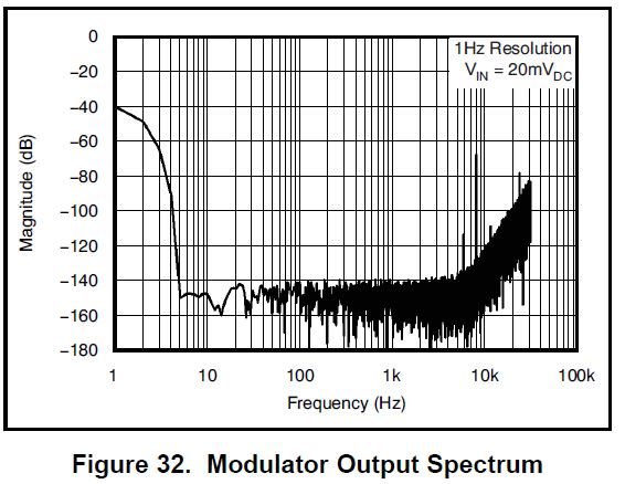

    Since we are using only the Sinc filter which has lobes around the harmonics as well, what is its impact on the noise performance and ENOB? If we are running at 16ksps, the decimation ratio is pretty small around 64. What is it's effect on ENOB?
    The noise performance won't be very good when using the SINC filter, because the high-frequency modulator noise will start to appear in the output result (this noise is normally filtered out when used with the FIR filter).
    Typically, the SINC filter on the ADS1282 is only used as a "pre-filter". For best performance, it should really be followed up with another post-processing digital filter to remove the modulator noise... However, this may added too much latency to your particular application.
