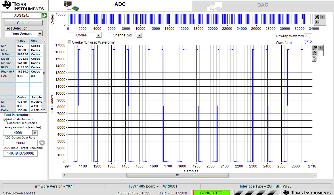

 Recently, we newly purchase a ADS4249EVM combine with TSW4806EVM and TSW1405EVM for analog data acquiring.But
First, I find I can not connect to the USB to ADS4249EVM. While for TSW4806EVM and TSW1405EVM, I can easily connect it well.
Second, after I connected all the cards, I find the output from High Speed Data Converter Pro Software is strange. For example, if I input the sine wave signal, I will get some strange wave in codes form.Like some square wave with top and bottom carve oppositely. Will anybody tell me why, thanks a lot!
Input is sine wave with Vpp=1V, output is as following,
  • Dewen,
    Are you able to write to the ADS4249EVM or are you using parallel programming mode? The data looks like the format is wrong coming out of the ADC. Switch the mode to 2's compliment. If it is already using this mode, switch it to unsigned binary.
    Jim
  • Thanks, Jim. I have switched, it works, the coding wave is normal now. Thanks a lot!
