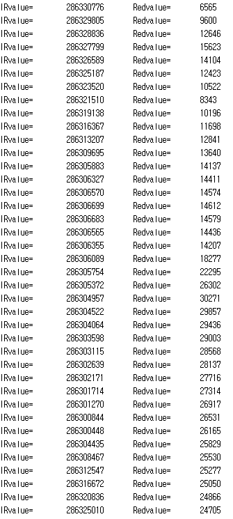

I test the Osram SFH7050 sensor.
The output of red, ir value is strange.
When i put on my finger on the sensor, output value is over 22bit format such as 286330776,286329805.
The output variable type is uint32_t.
The  ir, red value output strange value respectively or simultaneously.
Below picture is the output value.
However, the output vlaue is normal when I take off my finger on the sensor
I test five or six SpO2 sensors, this phenomenon is shown by some SpO2 sensors.
I tried  changing LED current and TIA gain but not improved.

  • Hi Sangkyu,
    Though the AFE4400Read function read only 24 bits from the AFE, the results who have attached have 32 bit data.
    ‭‭Example: 286330776‬ = 0x11110F98‬
    Please check your code if you are appending any data after the read function call.

  • I found the why occuring error.
    The data lower than 2^15(0d 32768) is not problem.
    But,the data larger than 2^15(0d 32768) is output the error data like below picture.
    Bht, I don't know the reason.
  • Try casting each byte to uint8_t or masking with 0xFF. You also need to check bit 21 if you are reading subtracted ambient data, in case you have -ve data.
    int32_t data = ((datah&0xFF)<<16)|((datam&0xFF)<<8)|(datal&0xFF);
    if (data&0x200000)
    data = -(~(data-1)&0x3FFFF);
