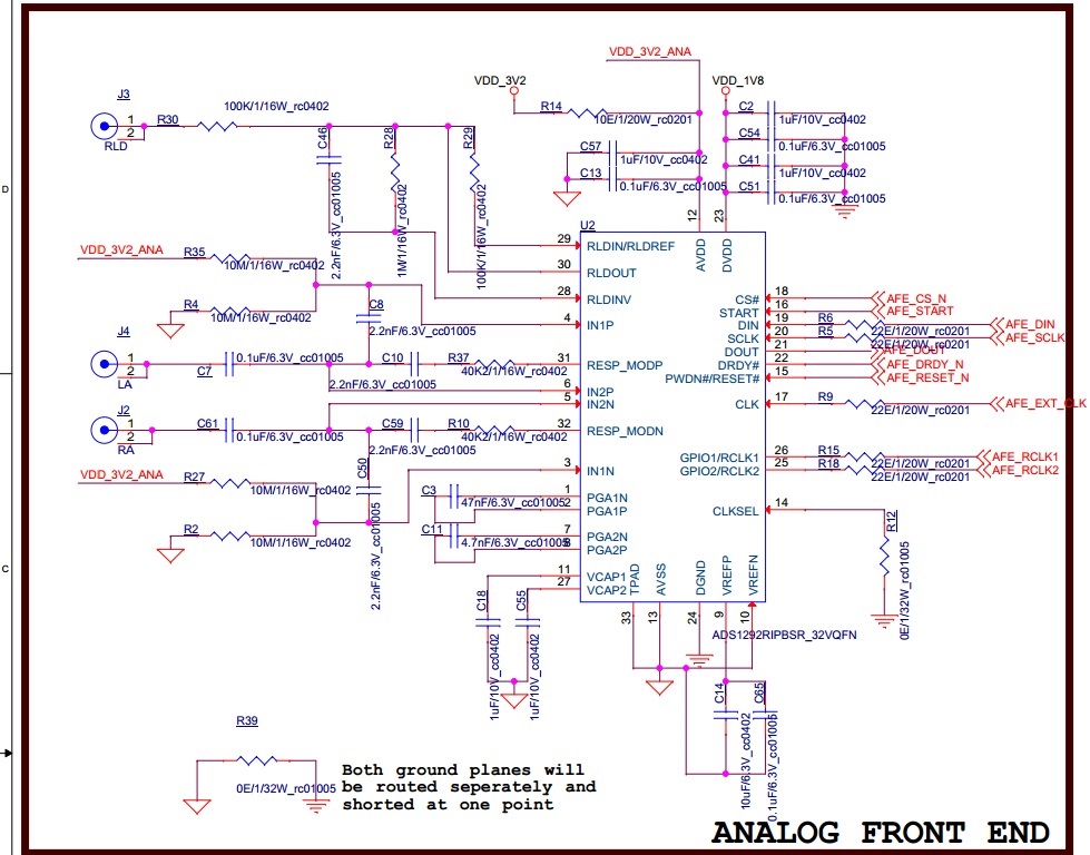

  • Hi Tom,
    Please find attached the schematics of AFE module.
    Please note that we are providing 1.8V to DVDD of ADS1292R. We think it is fine as the device datasheet says the range for DVDD is 1.8V-3.6V.
    Kindly review the schematics and let us know your feedback on it.
    Also, can you please throw some light towards the question about default/idle state of  MOSI(DIN) and MISO(DOUT) pins?
    Also today we tried driving the ADS1292R with internal clock(default design to drive from external clock) as well, but the result seems to be the same(no response to our commands).
    Umakanta Patro
  • Hi Umakanta,
    I don't see anything obvious in your schematic that would be causing these problems you are having with the ADS1292. The MOSI and MISO being 'high' while inactive may be related to how your processor is configured (internal pull-ups active?), but in general that should not cause a problem. What would it take for you to send us a screen shot of an actual SPI write or read transaction to the device? Have you more than one board at your disposal? If so, do you see the same behavior with multiple boards?
