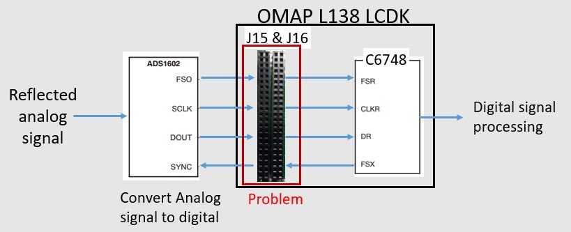

    Second, the reflected signal (after hitting an object such as a fish) is received by our transducer. The received signal is analog, hence, using ADS1602, this analog signal is converted to a digital signal (Fig. 2).
    Figure 2

    Question 0: We have 4 output pins from our ADS1602, namely FSO, SCLK, DOUT, and SYNC. These four pins should be connected to which J15 or J16 extension pins?

    For Q0 - there are three outputs (FSO, SCLK and DOUT) and one input (SYNC) to contend with.  Unfortunately there is nothing I see on J15 or J16 to connect them to.  The expansion headers do accomodate some SPI signals, but the ADS1602 does not have an SPI compatible interface.

    A Serial Peripheral Interface (SPI) uses a burst mode clock.  There is an SPI master that sends a fixed number of clock cycles to receive a defined number of data bits from the slave device (usually 8/16/24 bits, etc).  There is a chip select, data to and from the master (MISO and MOSI) and the serial clock, which is only active while data is being transferred between the master and slave devices.
    The Multi Channel Buffered Serial Port (McBSP) is a little different, it has a defined 'frame sync' signal and the serial clock is continuous.  The data word is defined (8/12/16/24/32 bits, etc) but the start of the received word is dependent on the frame synchronization.   The McBSP can emulate an SPI interface, but most SPI interfaces can't work with the Frame Sync and a continuous clock.  A complete McBSP interface has both receive and transmit clock, frame sync and data but the receiver and transmitter can run independently.  In the case of the ADS1602, only the McBSP receiver is used along with a GPIO function to initialize the SYNC input.
