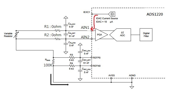

I try to measure thermistor values using ADS1220EVM's RTD Terminal Block J2. And I follow the spec described in user guide

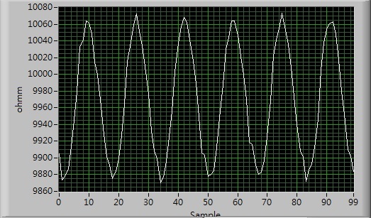

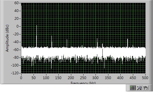

But there seems to have 60-Hz noise even if I enable FIR filter 50/60Hz Rejection
Any idea??
brief schematics
my setting;

    The 50/60Hz rejection only works at 20sps.  At 600sps, 60Hz is well within the passband.  If you require the faster data rates than you will need to provide an external filter by changing the 0 ohm resistance of R1 and R2 to something that will create a low pass filter in combination with Cin_diff.
    However there are tradeoffs having large filter components both with noise and analog settling.  You could try values such as 4,7k resistors and a differential cap in the range of 0.33 to 0.47uF.  Also, you will need to drive the excitation current through a different path to avoid the filter resistor.
