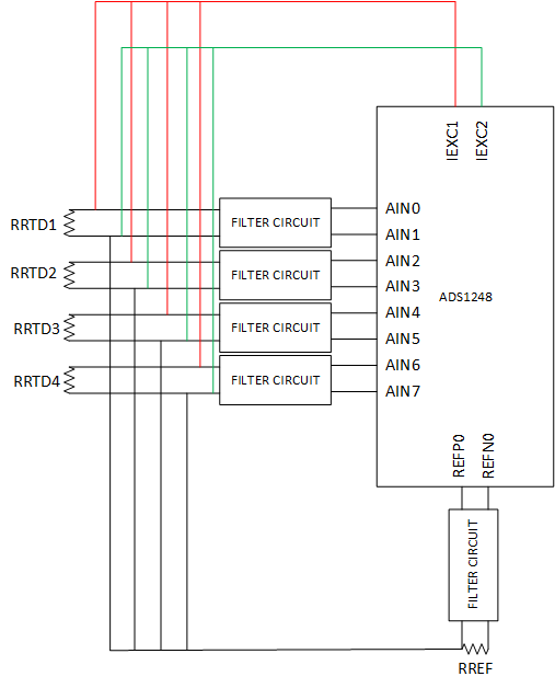

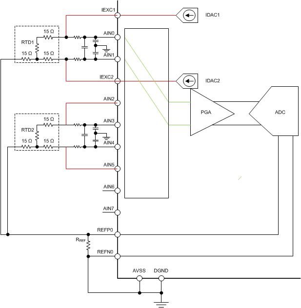

I'm attempting at using the ADS1248 with an Arduino to measure the temperature of a 3 Wire RTD. I've set up my circuit as per the Figures 110 and 114 in the data sheet with the only major change being that both AVDD and DVDD are connected to 5V supply as the SPI signals are being generated by the UNO (which are at 5V).
I am able to successfully write and read from the registers and have followed the setting of the registers exactly as per the Table 49 of the data sheet.
Additionally, I am using the pseudo code as a reference to write my code and have more or less followed the same.
Here is my problem, though:
I am able to measure the RTD resistance and actually using the CVD equation even get the temperature. However, when I move the RTD sensor toward a heat source, the resistance and the temperature does not change and then suddenly jumps - the jump is from 22 to 31 deg C. When removing it away from the heat source, the temperature remains high and then once again jumps back to the SAME 22 degC.

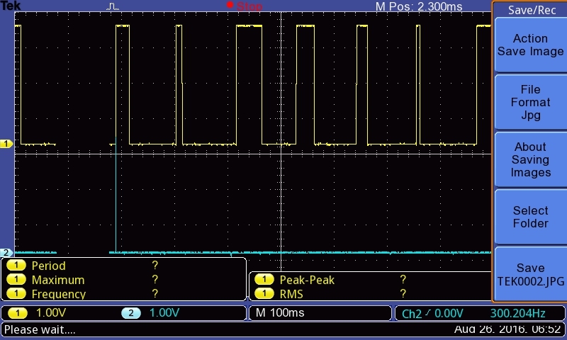

    First, can you post a length of conversion results? It might help to just get the 24 bit values first (converted to decimal is ok). It's easier not to have to deal with the conversion. I was curious about the nature of the problem, if you were getting exactly the same value out of the ADC each time, or if the value varied a little.
    I would also get a scope shot of the SPI lines (DIN, DOUT, SCLK, /CS), just to make sure that you're reading back the correct 24 bit data. A logic analyzer would be ideal (and you could grab /DRDY as well). You shouldn't have to clock in extra NOPs to get the data and you should be able to see the correct values coming out of the ADC lines. Make sure that /CS isn't returning high with each byte transaction (/CS should remain low for the complete data transaction). Since you're able to read and write to the device, you should have figured this out, but I'm mentioning this again, just in case.
    At this point it looks more like there's a problem with the arduino code and not the device. I've got limited experience with arduino, so I may not be able to help you as easily. However, check what I've written above and it may help you to get a solution.

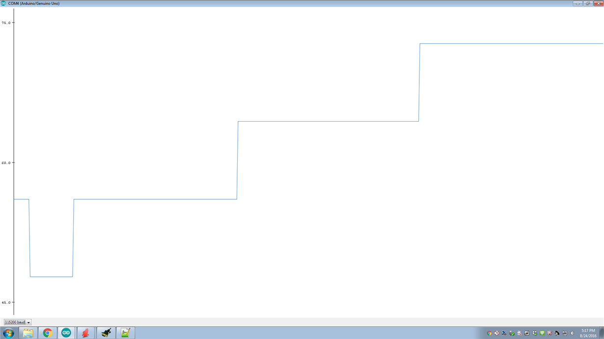

    Now, this data is:
    a)On the surface - really good.
    b) If you look closer, you will notice that weird jump from 22.86 directly to 31.13 - I just touched the sensor with my finger but even then it took the device two readings to eventually reach the value of 31.13

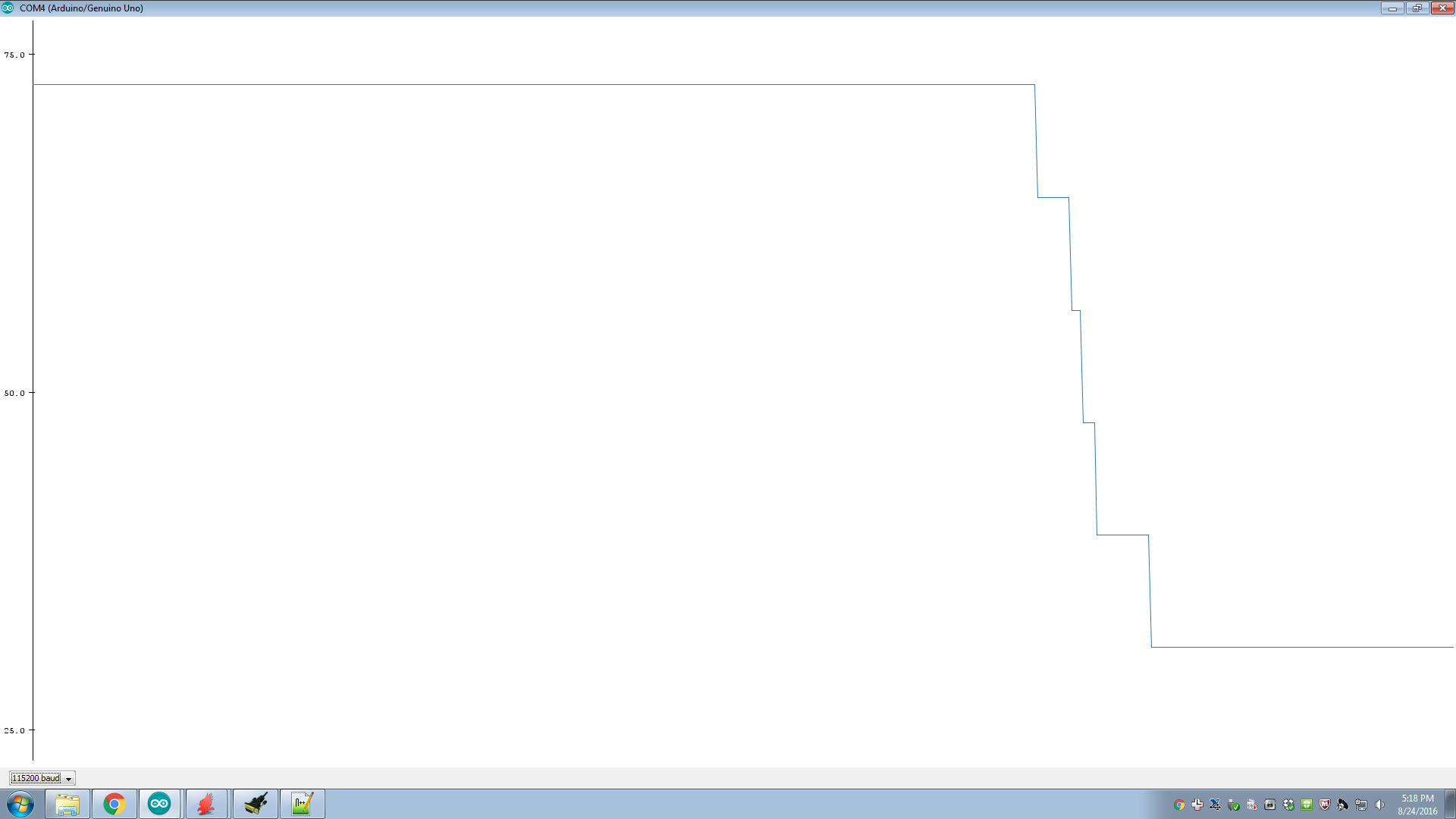

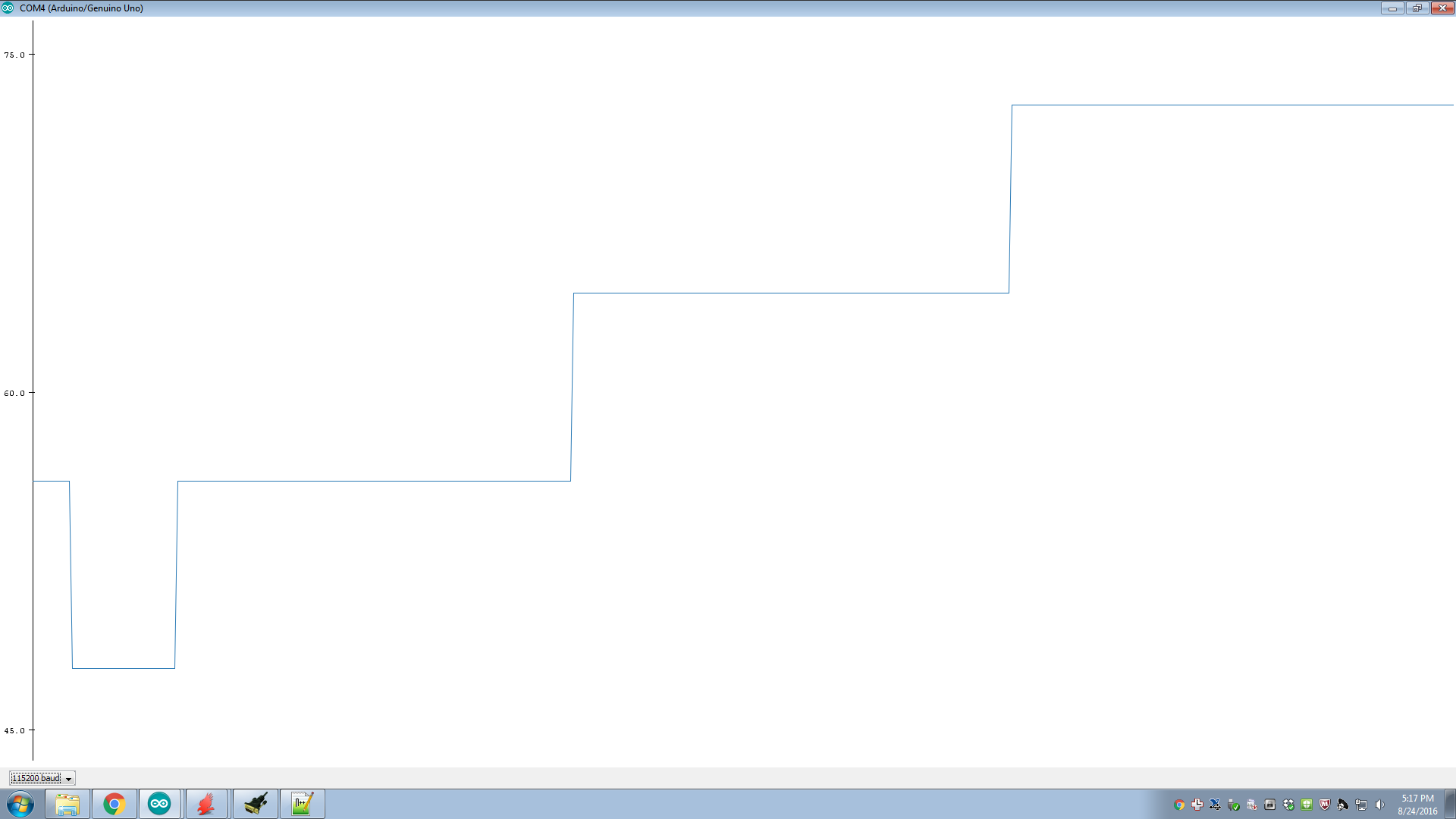

    c) This is what a plot of the output looks like when I used a heater -
    Some more heating...
    And then on removing it from the source, a steep drop:
    Which seems almost correct but I feel like without initializing the 'Data_Read' variable and setting it to '0x0' each time DRDY goes low, means I am ORing the last 8 bits of my current Data_Read with the first byte being read during the first 8 of the 24 clock cycles. Which would mean that this data above that seems "relatively" correct actually consists of:

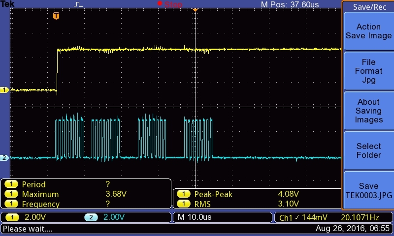

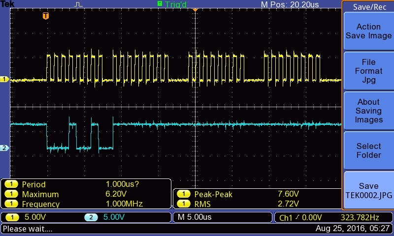

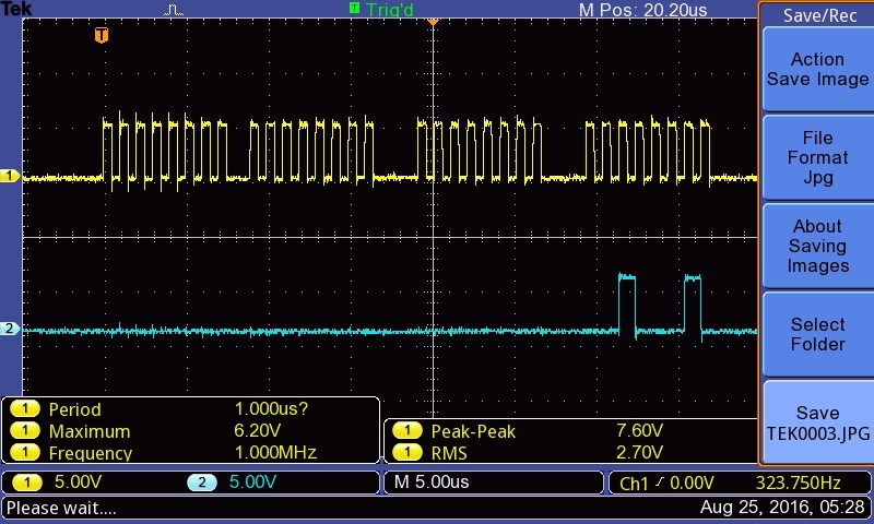

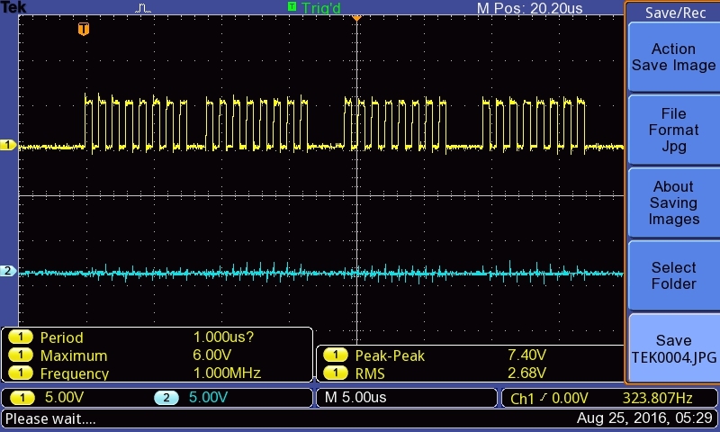

    Now the SPI waveforms. Unfortunately, I do not have a logic analyzer but have included the oscilloscope readings:
    DOUT and CLK:
    DIN and CLK
    CS and CLK:
    My concerns are about my conversion of data also I'm concerned about the resolution of the values that I'm getting - the random jumping doesn't seem right and the delay is making me wonder if I need to have any additional commands  - Just to be sure, I'm going to include my setup code as well here. I've commented most of my actions which I hope helps you decipher what I'm actually doing:

  • Joe,
    I'm not absolutely sure, but it looks as if you are reading the data back faster than the ADC is putting it out. I believe that the output data register is cyclic. If you read the output data, and then read it again, while the ADC hasn't updated with a new value, it will repeat the old data. In your output data, the output code looks like it stays the exact same value for several readings which indicates that has happened.
    To be sure, you could use the oscilloscope to capture the /DRDY pin to see what the data output is, and compare that with your SCLK or DOUT values. This would show you when the reads are happening compared to the ADC data rate. What is your current output data rate set to? I would try to increase that rate to see if you can get a better timing.
    Joseph Wu
  • Hi Joseph,
    OK. So, I tried to look into your comment about the reading speed vs the conversion speed. I was wondering if there need to be any additional delays beyond those mentioned in the pseudo code? I read in the data sheet that once DRDY goes LOW, the CLK has to be held low for a minimum amount of time so that the converted result is made available in the output register? Do, I need to do something like this?
    Regarding the SPI speed, I have kept it at 1MHz. I checked the results again (now only assuming that the variable used to store the 24 bit code is initialized to 0 before each read as this would obviously be the correct one) and surprisingly noticed that there was a more fluid change of (albeit junk) values:
    A24 Bit Data in Decimal:34

    These values were obtained by touching the sensor with my finger. It seemed much better than the earlier attempts where it would not budge for at least 2 reads - I'm not sure what I changed here or if it is actually any good.
    The DRDY pin vs the SCLK is shown below. I think it seems OK:
    But it was the consecutive DRDY outputs that looked a little bit off to me:
    Should they be uneven like this? Is this the cause of my problems and should I be changing something?
    Also, if these aren't the problems, could something be wrong with my hardware? I tried changing the sensor today to another PT100 of another manufacturer only to get the SAME results. :( - The SAME code output as well. Once again, I took some fixed resistors as a test case and tried to measure them using my setup and they seemed pretty accurate. This entire thing is really confusing me. Please help.

    I do have one additional query for which I have been perusing the forums for previous answers but haven't really found any concrete solution but I'm hoping you would be able to assist me here instead of creating another question. I understand that the ADS1248 can take a total of 4 3 Wire RTD sensors. Is there any existing schematic on how to connect such an arrangement? If not, from what I've determined, I understand that I could use the inputs AIN0 to AIN7 as inputs for the four sensors and tie the third lead of the RTDs to the SAME RREF across REFP0 and REFN0.  My confusion lies in the current source arrangement. I have noted that there are two current source outputs IEXC1 and IEXC2 but if I were to connect them to the leads of each of the RTDs would it maintain the same working? I only imagine the current flowing through the RTD being measured and the RREF being different because of this.
    This is a sketch of what I would do. Is it correct?
    Or should I be activating the excitation currents for the RTD being measured? My confusion there lies in whether the filter circuit would be a hindrance.
    Once again, please let me know if I should ask a separate question for this. Thanks!
  • Joe,
    Sorry but I was out on Friday.
    The result that you are getting 11111111111111111111111 is not FFFFFFh but rather 7FFFFFh. This is the positive full scale value. This means that the input is at the value or greater than the value of the reference. It likely means that the input is over ranged at that time or that the reference is much smaller than expected at that time.
    The diagram that you show for the RTDs is half right. The negative inputs for each channel is correctly connected to each other and routed to the reference resistor. However, the IDAC currents should be routed through the input mux to measure four RTDs.
    As shown there's no way in your diagram to separate the IDAC currents from one RTD to another. To be able to make four 3-wire RTDs work, you must route the IDAC currents through the AINx channels independently. To measure RTD1, route the IDAC currents to AIN0 and AIN1, to measure RTD2, route the IDAC currents to AIN2 and AIN3, and so on. The problem with this configuration is that it is sensitive to series resistance mismatches, so you likely won't be able to use filter circuitry at the analog inputs without adding a lot of error.

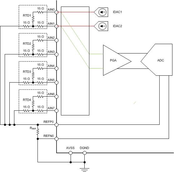

  • Joe,
    Here's a diagram showing an ADS1248 configuration with four 3-wire RTDs:
    Joseph Wu

    2. Thanks so much for the schematic. I kind of figured out over the weekend that if I wanted to use filter circuits at the inputs, I would only be able to use a maximum of two 3 Wire RTDs per IC. If I were to remove the filter circuits, my understanding is that I would just have to activate the IDAC current sources at the respective inputs at which the measurement is being taken and this way be able to measure 4 3 wire RTDs per IC.
    3. If my understanding is correct as per point 2, I will need to use multiple ADS1248 ICs as I have a total of 12 sensors to measure in a very noisy environment (I'm measuring the temperature off of magnets in an electromagnetic field). I wanted to know if I could use the same reference filter circuit and reference resistance for all the ADCs? I figure I would only need to use the reference resistance to hold the VREF value and if I could avoid redundancies.
    Thanks once again for all your help!
    Joe
  • Joe,
    I should also mention that the 15Ω resistors shown in the diagram represent the wire resistances for each of the three wires.
    Note that they should be relatively equal and that the two IDAC currents, if matched should cancel two of the line resistances. The third line resistance is not part of the measurement, and merely makes a small shift in the common-mode voltage.

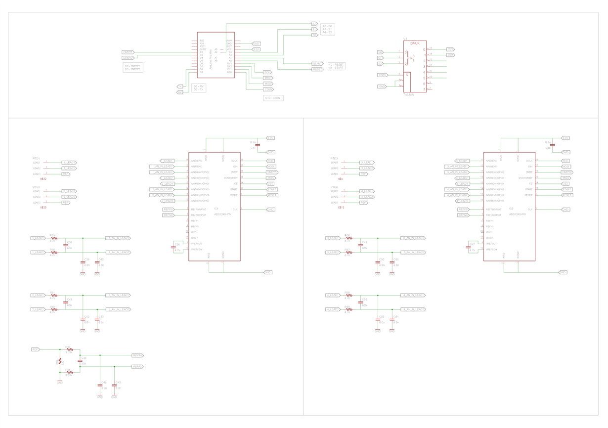

  • Hi Joseph,
    I'm including a rough schematic considering a total of four RTDs and two ADS1248. The individual CS pins are held low with an inverting demux. The DRDY pins are being read individually (and will be polled) using the individual inputs of the microcontroller. The START and RESET pins will be set high and will be common for all the ADS1248.
    But most importantly, based on our former discussion, I am not making ANOTHER reference resistor filter circuit for the second ADS1248. Is this OK?
    Other than that, please let me know if there are any contentions with the circuit.
  • Joe,
    In general, your schematic looks ok. I can't think of any reason why you shouldn't be able to share the reference resistor, except that it might be difficult to layout. Most of the time, the capacitances will be placed close to the device inputs, and you may not be able to do that in this setup, so noise pickup might be an issue. I didn't take a detailed look at the multiplexer governing the /CS, but I think it should work. I did have a couple of comments though.
    First, you need to attach VREFCOM to ground. Here VREFCOM is floating for both devices, and an AC ground connection is required.
    Note that you are using the internal oscillator for both devices. That means that the clocks for the devices won't match. You might have problems if you absolutely need to sychronize the timing and are just letting the device free run. However, you can set the device and input to be measured, run a SYNC command and then wait for the next /DRDY indication.
    I see that you have some filter resistors on the reference inputs. In general, I don't think they're really necessary for the performance. Most of the time, I've used just some basic capacitance across the reference input. However it's fine to leave the full filter in.
    Other than that, I don't see any other issues with the schematic.
