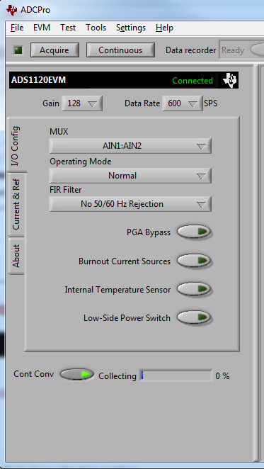

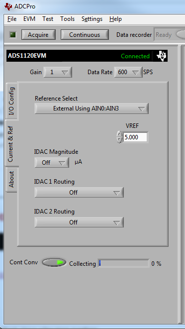

  • Hi Adriana,
    You could use the internal reference, but it is often better to make the reference ratiometric to the sensor by using the excitation voltage as the reference.  In this way the measurement will cancel any common noise and drift that is common to both the sensor and the reference.
    One way to accomplish this is to use the AVDD supply on the EVM by connecting the jumpers JP1 and JP2 so that J1/J5 are connected to AVDD and AGND.  The connections marked EXC+ and EXC- shown on the PCB silkscreen can connect to the supply connections on the sensor.  The output of the sensor would then connect to what is marked as IN+ and IN-.
    Once you make these connections and assuming you have chosen 5V for AVDD at JP3, you would set up the ADCPro so it looks like the following:
    After you have Acquired data, the data monitor will display the results with decimal values on the left side and binary 2's complement from the ADC on the right side (ADCPro imports the data to 32-bit even though the ADC sends 24-bit so the values are sign extended.)  It is the same result.
    The codes will shift to a lesser or greater degree based on the gain selection.  With the configuration I have given, the full-scale range will be +/- 5V/128 or +/-39mV.  So the code size (LSB) is equal to 5.96nV.  If you were to use a gain of 1 then the code size would be 596nV.  So you can see you would see a much different code shift relative to pressure depending on which reference and gain you use.
