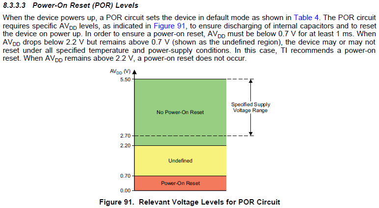

I understood AVDD must be below 0.7V for at least 1ms, and then be increased up to 2.7V(min) to ensure POR.
Could you tell me a state of output voltages of DACs under the condition of AVDD=0~0.7V for DAC7562-Q1?
Does these also show zero volts ?

    During power up an amplifier can often exhibit power-on glitch conditions unless very specific circuitry is implemented inside the device that reduces this power on glitch (or the designer was otherwise aware of and designed to minimize these effects). One of the factors that usually bears strong influence on the magnitude of this power-on glitch is the rate with which the power supply ramps.
    The POR will reset a number of things inside of the device when AVDD crosses the 2.7V threshold, among the actions taken is setting the DAC data register to the default value. There is no static memory inside of the device, though, so at power up the DAC data register should contain 0s assuming the device had been "off" for some period of time, otherwise it may be possible that the data is still present. So if this is a "cold-start" situation I think it should be fine, otherwise complying with the POR description you inserted in your post should avoid any problems.
    Depending on the supply ramp rate (and VOUT loading) I believe all that will be observed at the output is a power-on glitch, which could vary in magnitude. Slowing the supply ramp rate, loading the output with some capacitance, or loading the output with some parallel resistance to the intended load can all reduce the power-on glitch.

    I understood Power-on Glitch occurs during power-up as figure 35.
