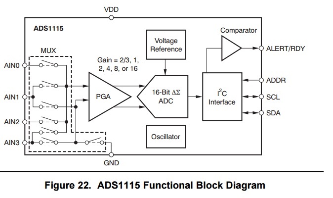

find the following internal block in the datasheet of ADS1115, but cannot find the related register to switch it. can you help please? for example, want to internally connect AIN1 to GND.

Hello JH,
Thank you for your query. Please refer to the CONFIG REGISTER subsection in the REGISTERS section in the datasheet.
Bits [14:12] of the Config Register configures the input multiplexer.
The possible combinations are:
000 : AINP = AIN0 and AINN = AIN1 (default)
001 : AINP = AIN0 and AINN = AIN3
010 : AINP = AIN1 and AINN = AIN3
011 : AINP = AIN2 and AINN = AIN3
100 : AINP = AIN0 and AINN = GND
101 : AINP = AIN1 and AINN = GND
110 : AINP = AIN2 and AINN = GND
111 : AINP = AIN3 and AINN = GND
Please refer to the ADS1115 datasheet for more details.
