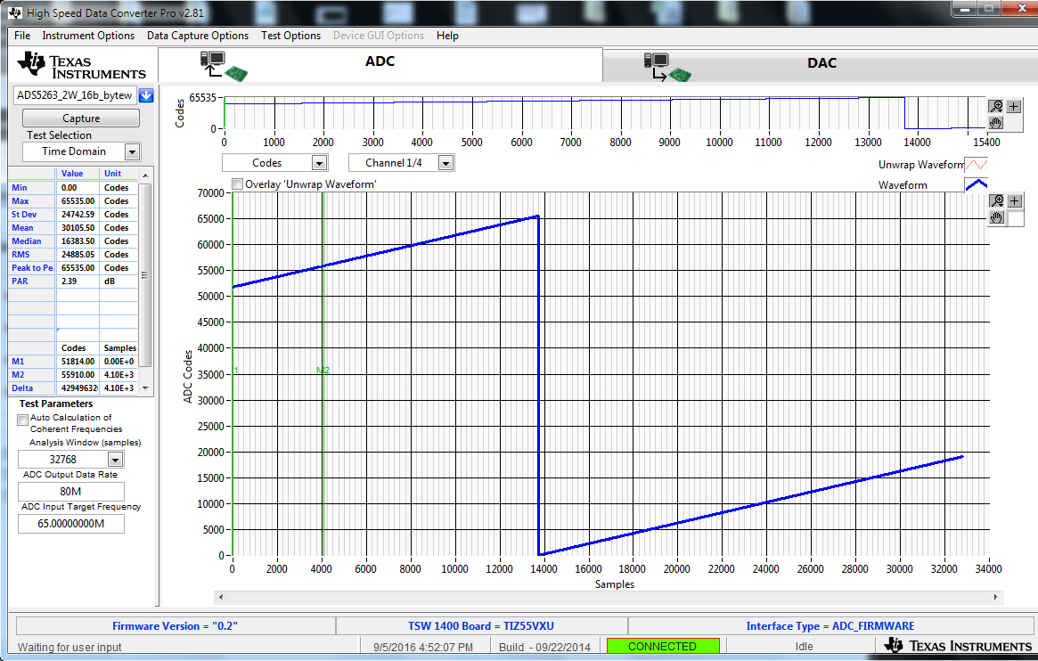

I am trying to get this dev board to work connected to a Cyclone V GT development kit. I am using the TI ADC to HSMC adapter board to connect the boards. Currently I have reduced the sampling rate to 20MHz on 1 lane in order to prevent any clocking time issues. The goal is to eventually run at the full 100MHz on 2 lanes. I have been able to get the deskew pattern of 0xAAAA to come back correctly. I have also gotten the 0xFF00 sync pattern to come correctly. I am having trouble getting the ramp correct though. Is there something I'm missing, I would of thought having these two patterns coming back correctly would be enough to get the timing correct but that doesn't seem to be the case?

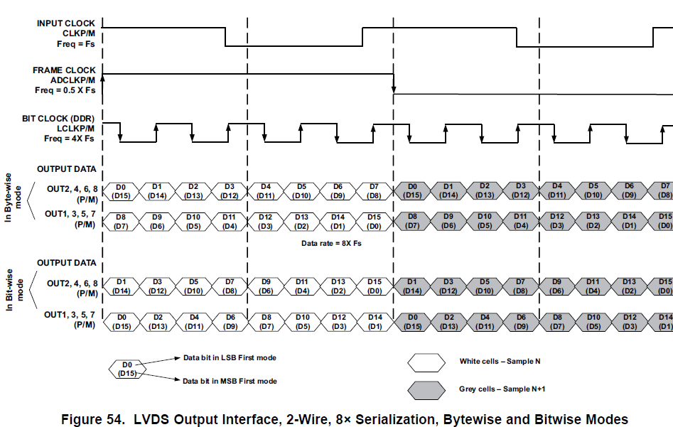

    If you are running at 20MHz (clock) on 1 lane (1-Wire) mode, assuming you are using the following:
    If you are running at 100MHz (clock) on 2 lanes (2-Wire) mode, assuming you are using the following data type:
    Please make sure your Cyclone V GT can run BIT CLOCK (by using DDR) up to Freq=4*100=400MHz
    (i.e., 800M DDR rate).
    And the Frame Clock = 0.5 *100=50MHz

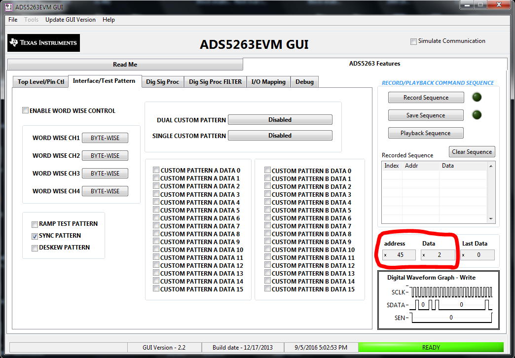

  • Hi Jason,
    For testing ADS5263 EVM by using TSW1400 EVM to capture the raw LVDS data.

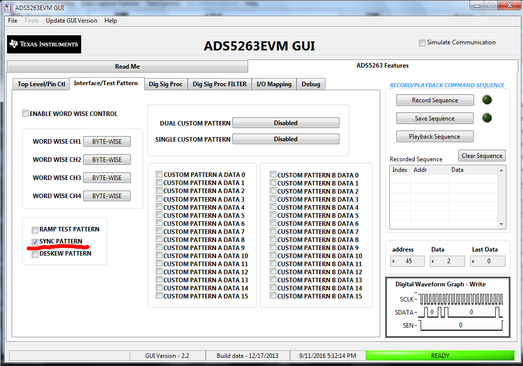

    1) We measured DESKEW pattern mode by setting Addr=0x45 Data=0x0001
    1) We measured SYNC pattern mode by setting Addr=0x45 Data=0x0002

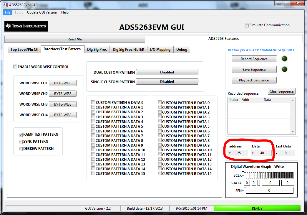

    1) We measured RAMP pattern mode by setting Addr=0x25 Data=0x0040
    Please try this way. You may capture correct output data.
    Thanks for using ADS5263 EVM.
    Chen'

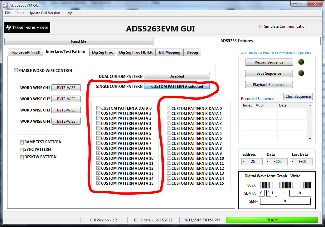

  • So, the problem I'm having is the ramp did not produce correct results running 20MHz on 1 wire mode. It looked like noise. This wasn't workign so I decided to go to 2-wire mode. So, I took the same component in VHDL, changed the word length from 16 to 8 bits. I then created two instances of them and concatenated them (ie. byte-wise mode). I then was able to get a correct ramp and deskew, but the sync pattern was reading 0xF0F0. However, when I applied the single custom pattern and set it to 0xFF00, it came back as 0xFF00. That being said I am using an Altera Cyclone V GT development kit instead of the TSW1400 EVM, but 20MHz should be easily doable. I also had trouble getting the double pattern to work from the menu. I set alternating patterns of 0xFFFF and 0x0000 and set the Dual Custom pattern, but I only saw 0xFFFF. I also noticed that it mentions bit-wise mode in the data sheet, but I see no register value that can produce it.

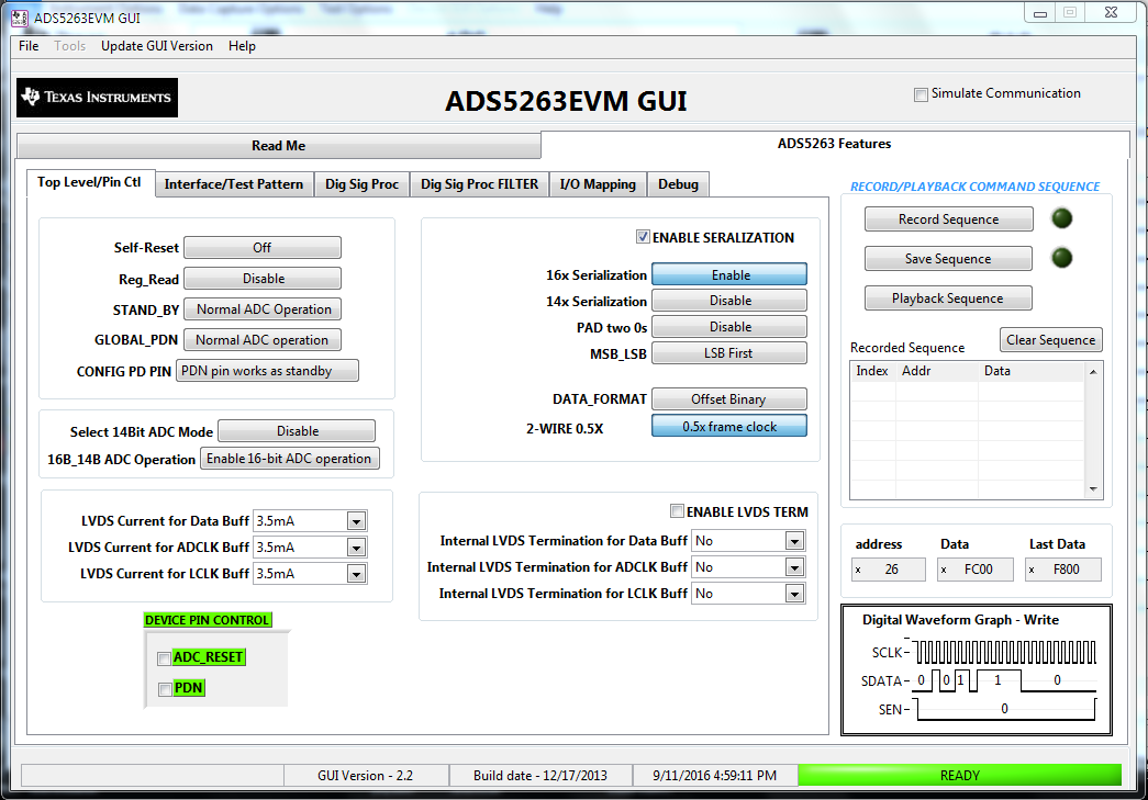

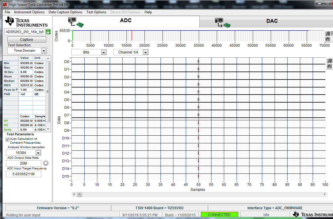

  • Hi Jason,
    Yes, we also followed your condition 2-wire mode and set the single CUSTOM Pattern on the register.
    as follows:
    And then we measured the signal output using TSW1400:
    The data shows 0xFF00 (same as you have seen.)

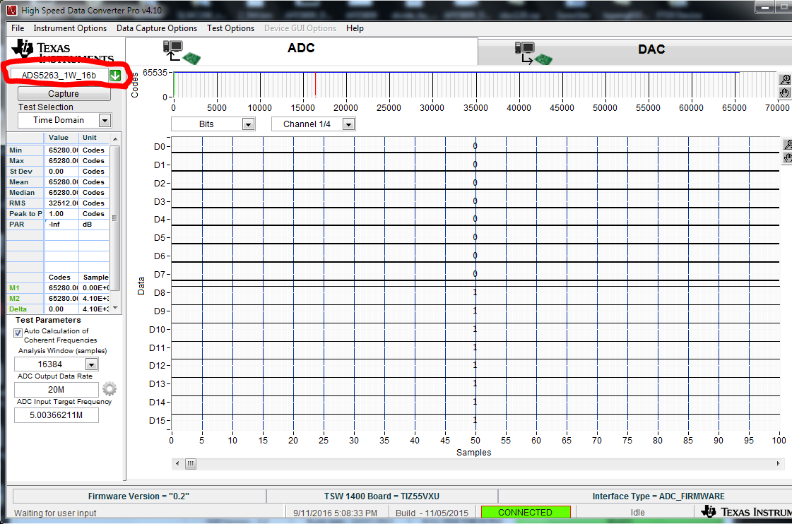

    Also, we tested 1-wire mode and set the SYNC Pattern on the register.
    as follows:
    The data also shows 0xFF00 (Note: this shows the output data are different between 1-wire mode and 2-wire mode).

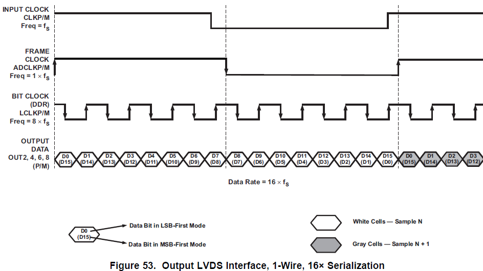

  • Hi Jason,
    So from the data sheet, it says Output data [15..0]=0xFF00
    That could mean it is only for 1-wire mode
    but not for other modes.
    I would like to check with other engineers for this concern.
    Thanks and best regards,
    Chen
  • Hi Jason,
    Yes, from ADS5263 data sheet:
    D1 <SYNC PATTERN>
    0 Sync pattern disabled.
    1 Sync pattern enabled.
    All channels output a repeating pattern of 8 1s and 8 0s instead of ADC data.
    Output data
    [15...0] = 0xFF00
    This data sheet SYNC pattern is speced:
    [15..8]=0xFF
    [7:0]=0x00
    for the 1-wire mode.
