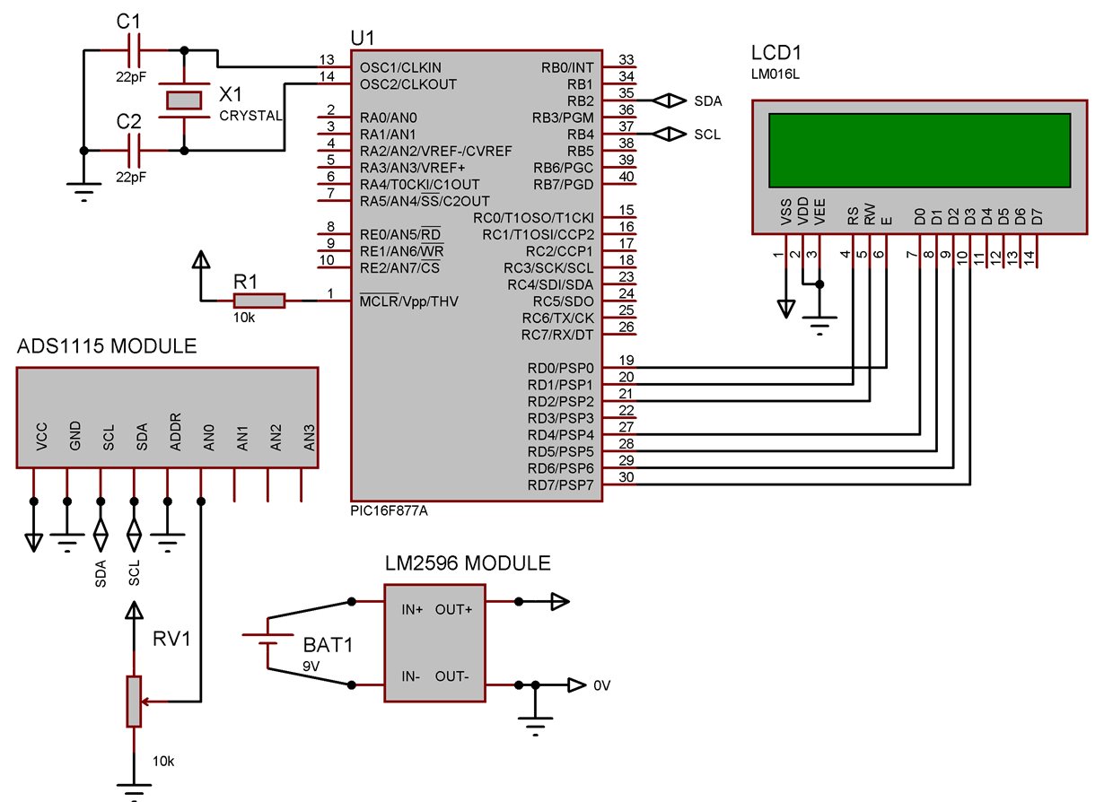

I'm working on the development of a high-precision voltmeter/ammeter project.
I selected the ADS1115 chip since it features 16 bits of resolution and also because it was available at some local electronic shops in my city. I also decided that the first stage of my project should be the testing of the ADC.
So I bought the ADS1115 module from Adafruit which features the chip itself plus some other components that makes the circuitry implementation even easier. (schematic can be found here: github.com/.../ADS1X15-Breakout-Board-PCBs)
My setup is quite simple. A PIC16F877A communicates with the ADS1115 and 'prints' the readings to a LCD16x2. The ADS1115 chip reads analog voltage from a 10K ohm potentiometer.
The code I'm using in PIC C compiler  is shown below and it contains lines of code with the configuration of the chip:

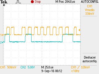

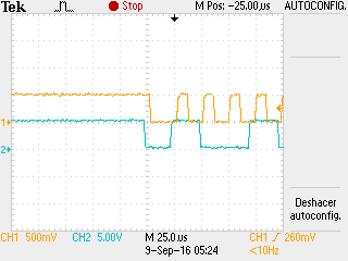

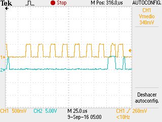

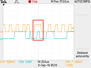

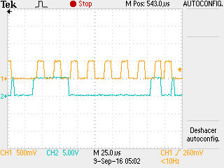

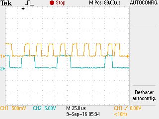

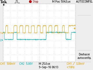

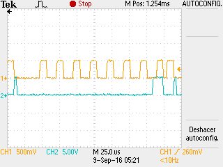

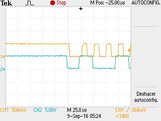

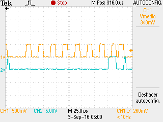

  • Thanks for your answer, Joseph.

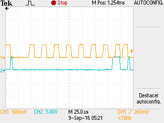

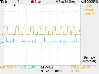

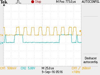

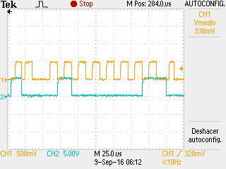

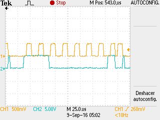

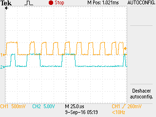

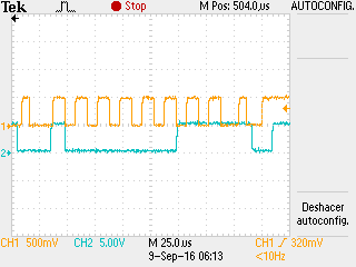

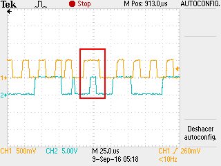

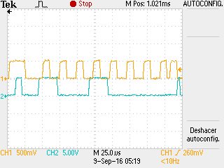

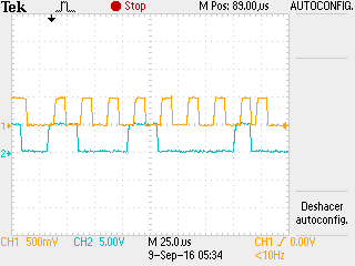

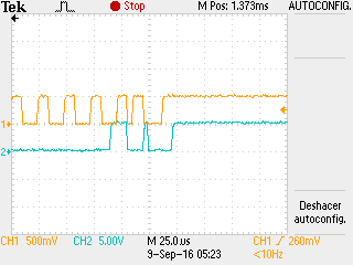

    As you said, I used an oscilloscope to measure the waveforms of the SDA and SCL lines.
    These are the results when I attempt to read the config register after a conversion:
    1. Start and First byte (write 0b10010000 -> address and write bit)
    2. Second byte (write 0b00000001 -> select config register)
    3. Third byte (write 0b11000001 -> start conversion, read from an0-gnd)
    4. Fourth byte (write 0b10000011 -> default)
    5. Stop and start (inside the red box)
    6. First byte (write 0b10010000 -> address and write bit)
    7. Second byte (write 0b00000001 -> select config register)
    8. Stop, wait 500ms, and Start again
    9. First byte (write 0b10010001 -> address and read)
    10. Second byte (read 0b01000001 -> OS bit is cleared)
    11. Third byte (read 0b10000011 -> default lsb byte from config register)
    Additionally, I tested the same code with an1-gnd, an2-gnd and an3-gnd and the results were the same.
    My schematic of the circuit looks like this:
    I also checked the voltage at the pin (by measuring voltage between the top of the pin welding spot and ground).
    I tried with continuous mode but OS bit stays cleared too.
    I guess that even though the I2C module of the chip is ok, the ADC module could be damaged for some reason I ignore (I've never put voltages out the range of 0-VCC to the ANX pins). What could have happened? Or maybe I overlooked something in the oscilloscope waveforms?
    A couple of days ago I bought another ADS1115 module, and I'll be testing it soon.
    Thanks again for your answer.
    Marco.
  • Marco,
    Before I start, I noticed that I had written my response incorrectly. I should have started with "I'm NOT the best at looking at code...." I generally help with ADCs and how they are used from a circuit perspective. I don't do a lot of coding and therefore, I'm really not great at reading through it.
    Going back to the scope shots, right now it looks like you have:
    Write to device, config register, C1 83
    Then STOP/START
    Write to device, config register, wait 500ms, read from the device, get back 41 83
    I would try to change the timing of the read and treat the 5 byte transaction as a single operation. Instead of what you have, try:
    Then STOP, wait 500ms, then START
    Write to device, config register, read from the device, get back two bytes.
    My concern would be that by starting the read and then waiting that the read has already started and that the configuration data is already moved to some output shift register. In this case, you're splitting the read up so that the data comes from before the 500ms delay. This would explain why read back of the OS shows that the part hasn't completed the conversion.
    Joseph Wu
