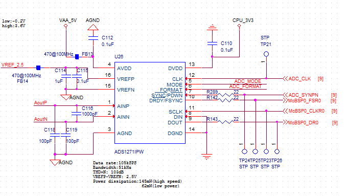

I wanna to use McBSP on the C6748 to connect  ADS1271. The ADS1271 works at SPI mode. The schematic is  as follows.
The code is as follows:

ADC_SYNPN is to provide a 1MHZ pulse to start ADC conversion. But McBSP0_FSR0 never generate signal from ADS1271. The reason is that
ADS1271 cannot  work on SLK "always on" mode?
How can I use McBSP on C6748 to read ADS1271? Should I change ADS1271 mode to Frame-Sync mode? Note my sample rate should be 50*1024HZ.
