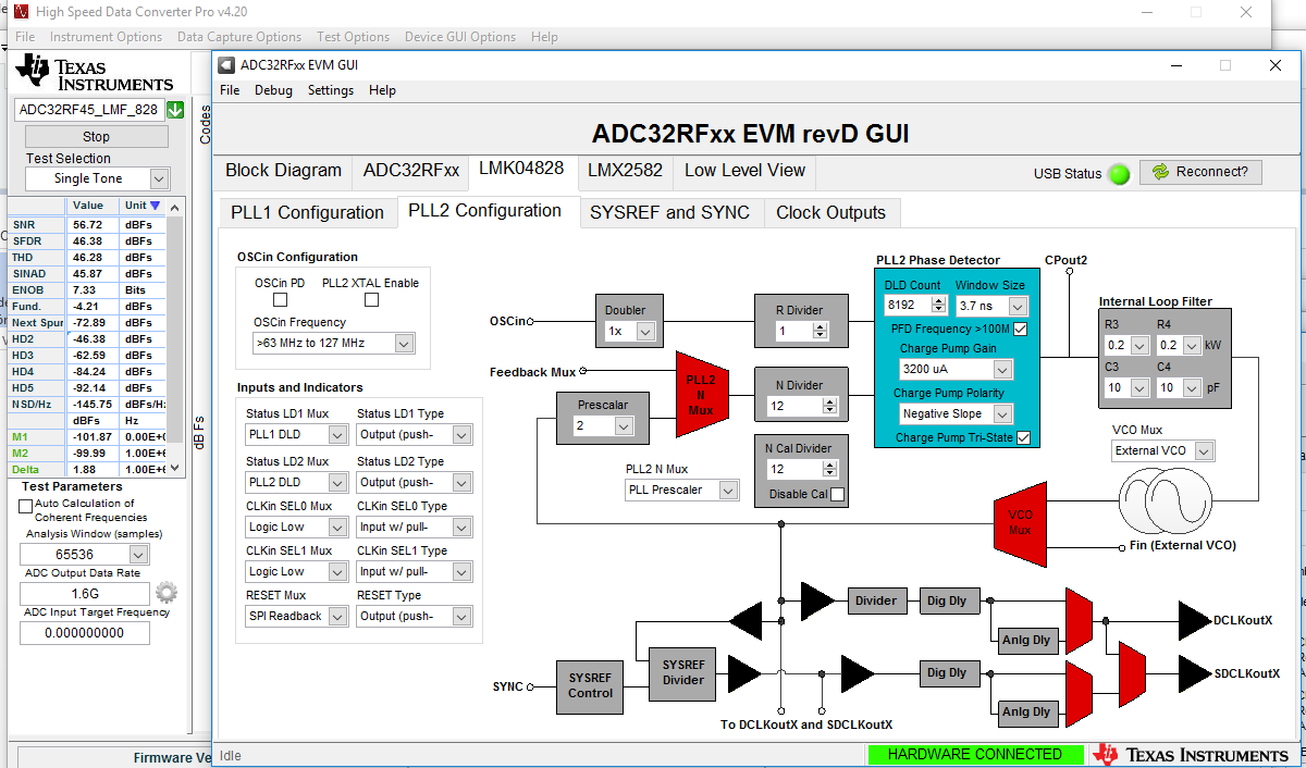

 I have been evaluating the ADC32RF45 for a few days by means of an ADC32RF45EVM + TSW14J56EVM and the original cfg files provided along with the EVM's software.Currently I am configuring the EVM so that I can generate the ADC's sampling clock from an external signal generator, and after many tests, I observed that the ADC's performance in terms of interleaving spurs suppression appears to depend on the selected sampling frequency. For example, the spectrum that I get after digitizing a 666 MHz analog tone is:
1500 MSPS: Not very bad
1600 MSPS: Similar thing
1700 MSPS: Interleaving spurs increase quite dramatically and noise floor appears colored (¿?)
1800 MSPS: Same thing but even worse
1900 MSPS: Good performance back again
This phenomenon was repeatable on all tests that I performed, and it does not depend on the analog input tone's frequency. I mean, I tested many different frequencies between 10 MHz and 800 MHz with the same results: whenever the sampling rate was between 1700 - 1800 MHz, interleaving images suppression decreased significantly. I even tried to vary the frequency of the input tone so that the digital frequency of the sampled signals (i.e. the frequency in rad) was the same on all cases, but again, depending on the sampling rate I got better or worse interleaving spurs suppression. If somebody is interested in seeing the rest of the captures I made -maybe for a comparison- I can upload them, just tell me. There are quite a few.
I would like to know if this phenomenon is normal, or if I could be messing the setup somehow, since the converter's specifications are given for sampling rates of 3GHz (or something like that) on the datasheets. About my setup and setup proceure:
- HW and SW: ADC32RF45EVM rev D + TSW14J56EVM rev B, HSDC Pro v4.2 and ADC32RF45 EVM 2.1, both running on Windows 10.
- The EVM is configured as indicated in the ADC32RF45 User Guide. Config files are LMK_ADC32RF45_LMF_82820_ExtClock.cfg and ADC32RF4x_12bit_LMFS_82820.cfg, written in that order after a reset on the LMK, and with an intermediate hard reset on the ADC.
- I'm using a single clock source to provide the ADC's clock and the LMK04828's reference by means of an splitter. The generator is adjusted so that power is about 7dBm at the EVM's SMA connectors. The clock is BP-filtered to suppress any harmonics.
- Power consumption is about 1.3A before configuring the LMK and ADC, and about 1.8A afterwards. Power supply is limitted to 4A and the current limitter stays off all the time.
- The analog signal is synthesized by means of a second signal generator and some BP or LP filters depending on the tests; input power is about 2-3dBm at the SMA connector.

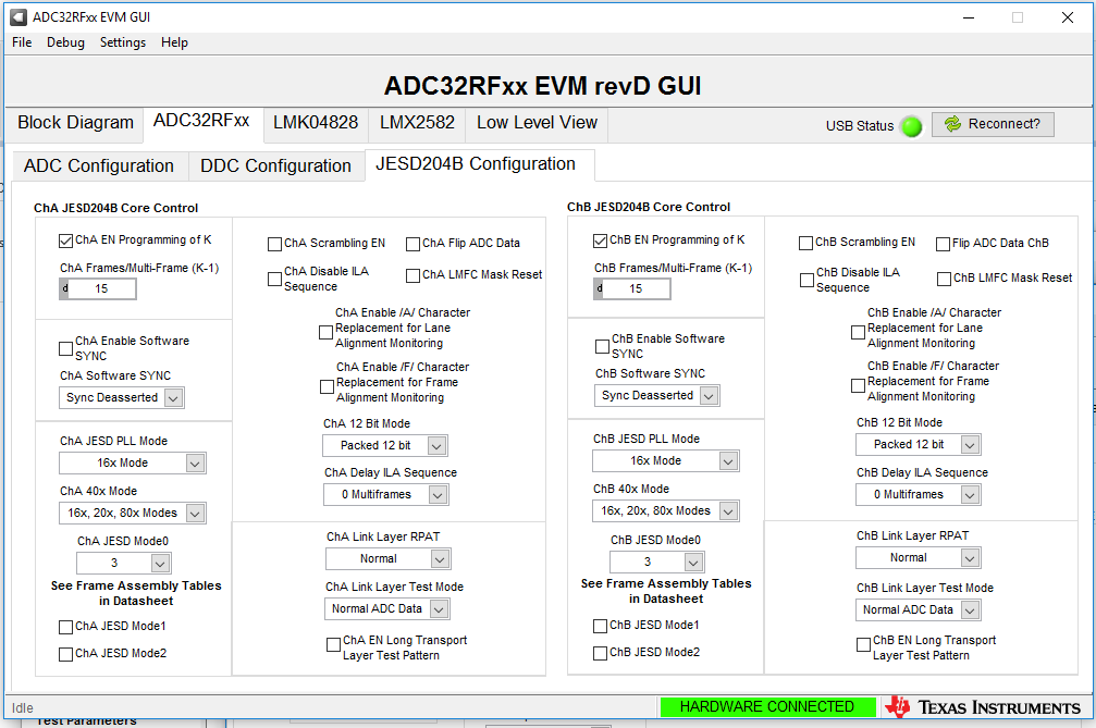

Some captures of the EVM software showing ADC and LMK configuration:
The "Slow speed En" was adjusted depending on the actual sampling rate (< 1.75 GHz for 1600 and 1700 MSPS) with no impact on the results.

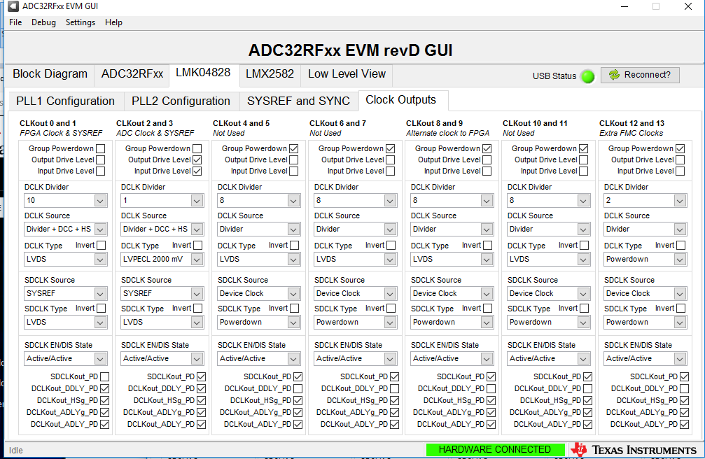

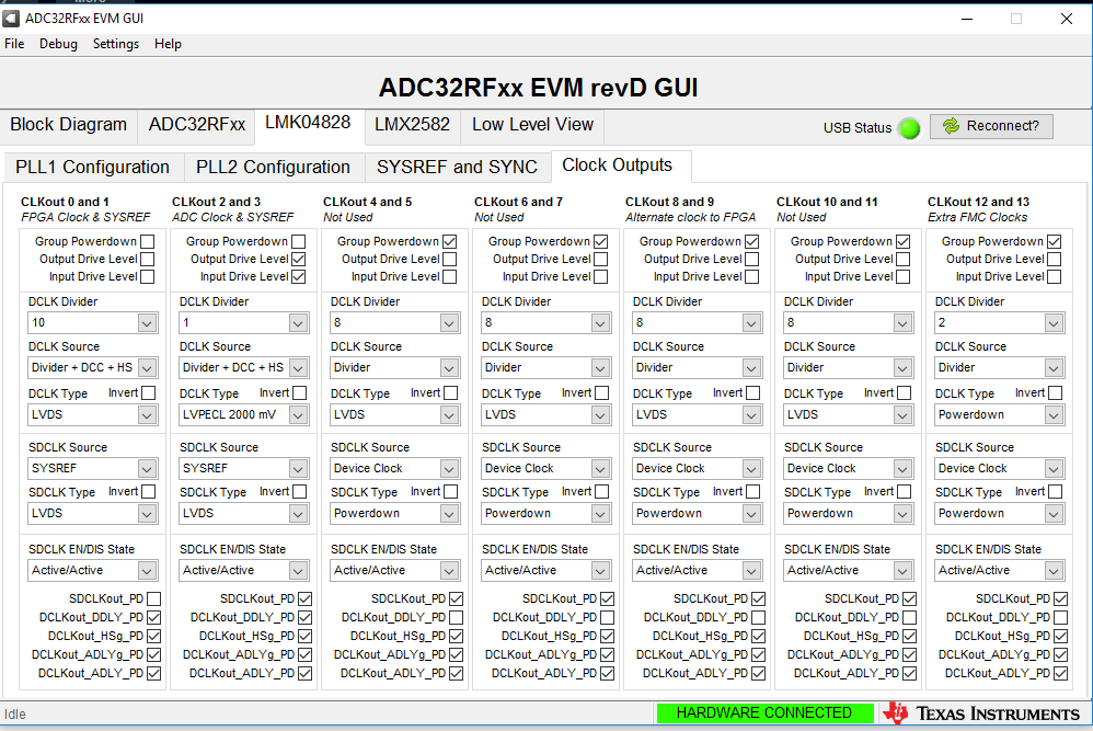

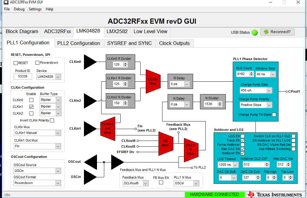

LMK04828:

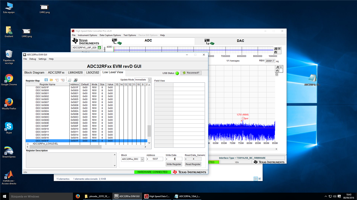

    - On the other hand, I am unable to enable the test pattern at the digital block level. My intention is to enable this test pattern so that I can capture it directly on HSDC and them export it to Matlab for further inspection (as this would answer my previous question). From what I read on the datasheets, it should suffice with writting register 0x037 at the decimation filter page (according to the datasheets, the decimation page accepts direct addressing), but so far I could see no test patterns at all. What I have done to try to enable it is to write 0x04 to address 0x5037 in the decimation filter page, as depicted below:
    Could you please help me with this?

    Setting up a test pattern like the arithmetic ramp is easy in the 12bit LMFS=82820 mode as there is just the one DPI bit to enable it.    For the DDC modes, I have been given a short sequence of SPI writes to set up both channels to output a ramp.  It uses addresses x037 and x038, as well as x039 and  toggling a bit at address x03A.    I haven't reconciled this little script with what I see in the datasheet, but I was handed this script and I have used it, and have seen the resulting ramp pattern out.   I have not added these test modes to the SPI GUI yet but I will be.   I saved this into a cfg file of its own that could be loaded after the other cfg files. Please see attached.   ADC32RF4x_DDCmodes_ramp.cfg
    0x5839 0x00
    0x5837 0x44   // Pattern Code for ChB: all_0=0x11, all_1=0x22, toggle(16h'AAAA/16h'5555)=0x33, Ramp=0x44, custom_single_pattern1=0x66, custom_double_pattern1&2=0x77
    0x5838 0x44   // Pattern Code for ChB: all_0=0x11, all_1=0x22, toggle(16h'AAAA/16h'5555)=0x33, Ramp=0x44, custom_single_pattern1=0x66, custom_double_pattern1&2=0x77
    0x583A 0x00
    0x583A 0x02
    0x583A 0x00
    0x5039 0x00
    0x5037 0x44   // Pattern Code for ChA: all_0=0x11, all_1=0x22, toggle(16h'AAAA/16h'5555)=0x33, Ramp=0x44, custom_single_pattern1=0x66, custom_double_pattern1&2=0x77
    0x5038 0x44   // Pattern Code for ChA: all_0=0x11, all_1=0x22, toggle(16h'AAAA/16h'5555)=0x33, Ramp=0x44, custom_single_pattern1=0x66, custom_double_pattern1&2=0x77
    0x503A 0x00
    0x503A 0x02
    0x503A 0x00
    Richard P.
  • Hi Richard,
     Thank you very much for the information and for the script. I checked the test pattern and the JESD204B link seems to be working all right on both channels, there are no glitches or missing codes in the ramps. Just a minor detail: as far a I know there is no reference to the DPI bit that you mention in the AD32RF45 datasheets, so I could not enable the test pattern for mode 80820. I loaded the script you attached instead, and what I saw was that each code in the test pattern is actually repeated 16 times (I suppose this is what you end up with when the DDC is disabled). You can see this "stepping" effect on the attached CSV file if you want.
