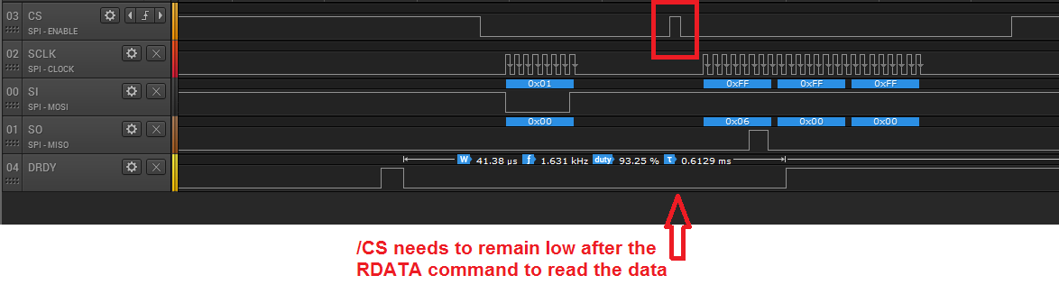

Here is logic oscillogram, that shows properly configuration o SPI and ADC (its saleae logic oscillogram with 10 sec length. Its difficult to make screenshot, that provide detailed information about signals). If there is no possibility to open then I'll send a screenshot.
16 MHz, 160 M Samples [22].rar
PROBLEM.
If you look at the trace, you may notice that after 360 ms there is a spontaneous reset. It occurs in different times, and only when reading data. If you configure the ADC and read the data, this is not a problem. The following waveform data without reading.
16 MHz, 160 M Samples [23].rar
On the last waveform reset does not occure.
As this problem occurs when any attempt to change source at the input. I have suggested that it may be either a defense mechanism within the ADC from the ESD or any another overvoltage, but I did not find anything in the datasheet.
Please any help in solving the mystery. Thank you!

  • Hi Maslov,
    Welcome to the TI E2E Forums!
    I looked at your Saleae logic analyzer screenshots and I see the "reset" that your referring to at 360 ms, where /DRDY is held high and then returns to its default 30 kSPS cycle period.
    Have you tried looking at the SPI bus using an oscilloscope (to see the analog voltages)?
    I believe you might have some ringing on the digital signals that the Saleae logic analyzer is not able to capture. The Saleae logic analyzer only shows the digital logic levels, and if it is not connected directly at the ADS1255 digital input pins, you may not be observing the exact same signal as seen by the ADC. Also, you could have some signal integrity issues if you're jumper wiring to the headers on your board. If the jumper wires are long or not tied together with a ground wire, they create large loop areas which can add significant inductance to the signal path.
    Also, since the RESET command is "0xFE", iI would recommend keeping DIN low (clocking out data using the 0x00 command) to avoid accidentally sending the RESET command.
    Aside: I also noticed that /CS is going high after the RDATA command. This is likely preventing you from reading the data. Make sure to keep /CS low until you've finished clocking out the data.
    Chris
  • Sry for delay!
    Thank you for your answer and support.
    Problem was found in digital supply voltage. I set 3.3 V LDO and with my oscilloscope i found, that it has 3.8 - 4.2 V oscillations that exceed maximum input voltage. I think this led to the fact that the input protection diodes enabled and the circuit was powered down for short period (reset).
    I have designed new scheme and PCB without cables and i hope it works.
    Artem
