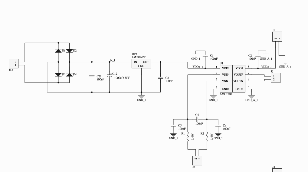

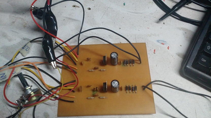

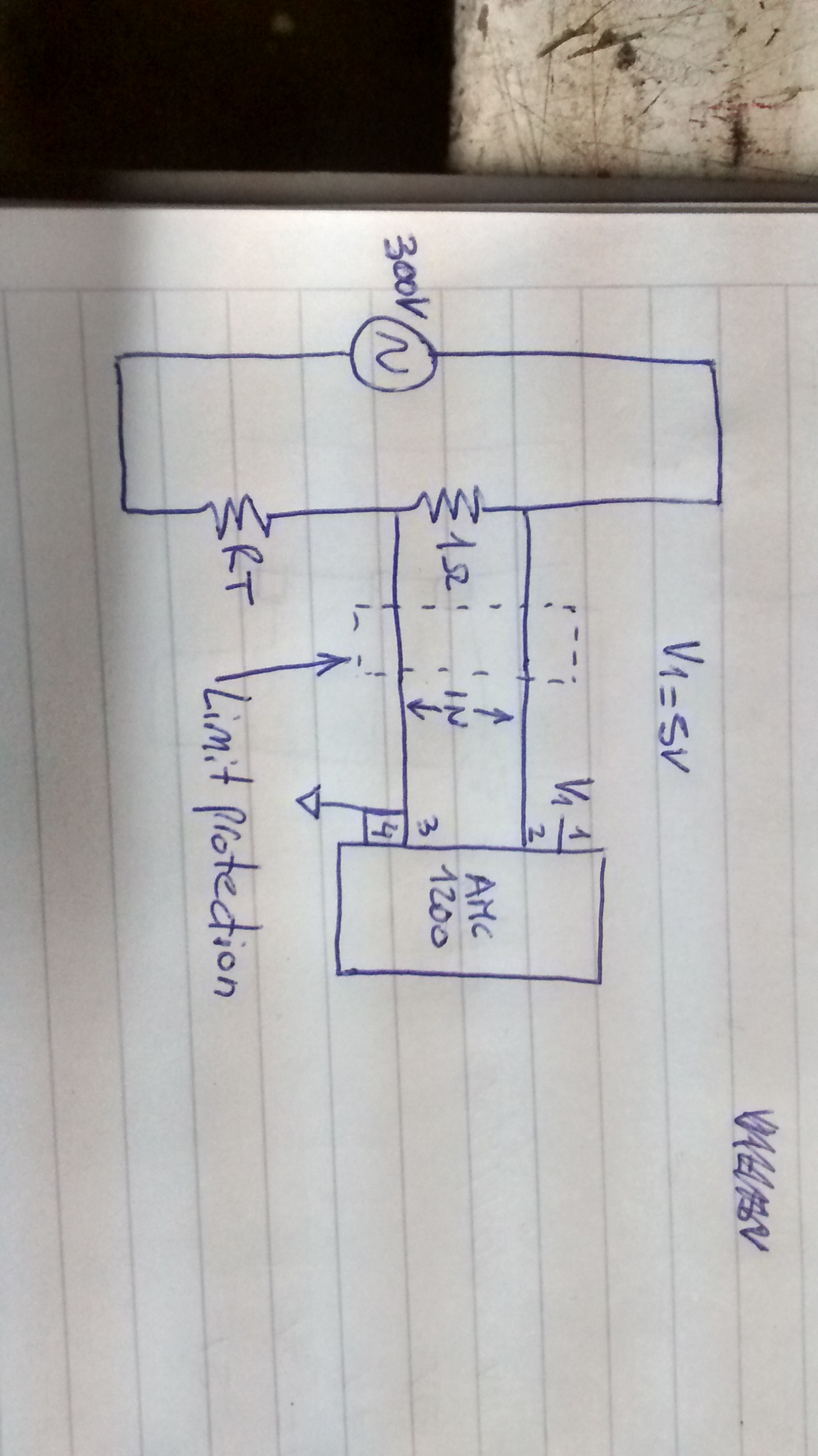

We have designed a new circuit with the AMC1200. The schematic and the test circuit are attached.

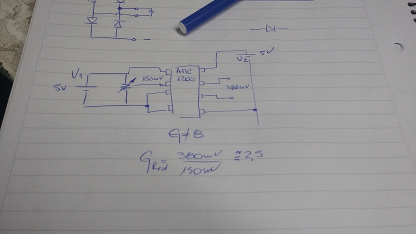

With two independent power supply, and a potentiometer between VINN-VINP when the input voltage is 150mV the output is 380.
Why is the gain different to 8?
