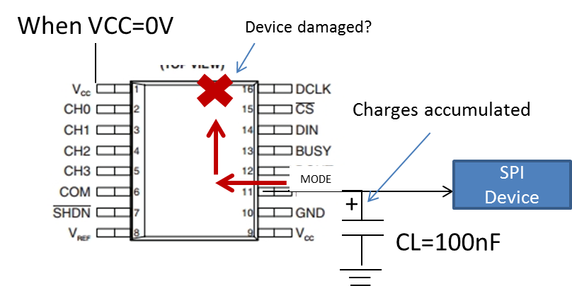

Hi
According to the datasheet, the digital inputs can be over-voltage tolerant up to 5.5V, regardless of VCC.
So, we think it is acceptable to apply 5V to digital input pins when VCC =0V.
How about digital output pins (DOUT, BUSY)?

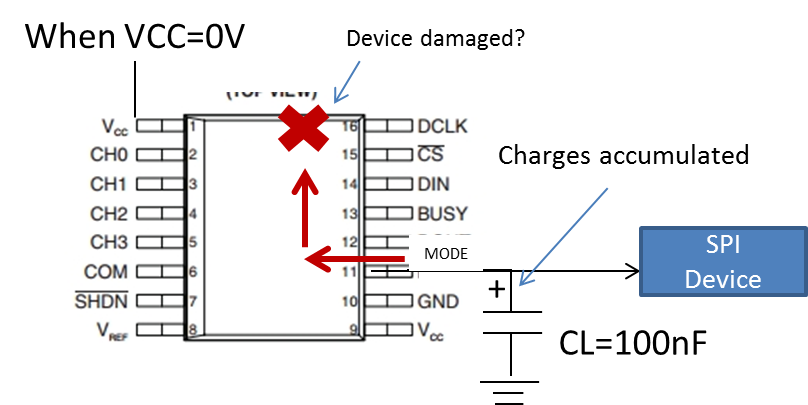

We are assuming the impact of capacitive load CL as follows.
What is the state of digital ouput pins when VCC=0V?
Is that acceptable?
