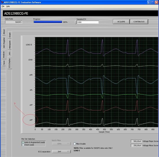

I'm evaluating the ADS1298 Evaluation Kit and I find some issues when I check the software waveforms. First of all, I configured all channels as normal electrodes, PGA=1 and high resolution mode. Then I connect this ECG simulator to the ADS1298 EVM and here there is the first captured screen:

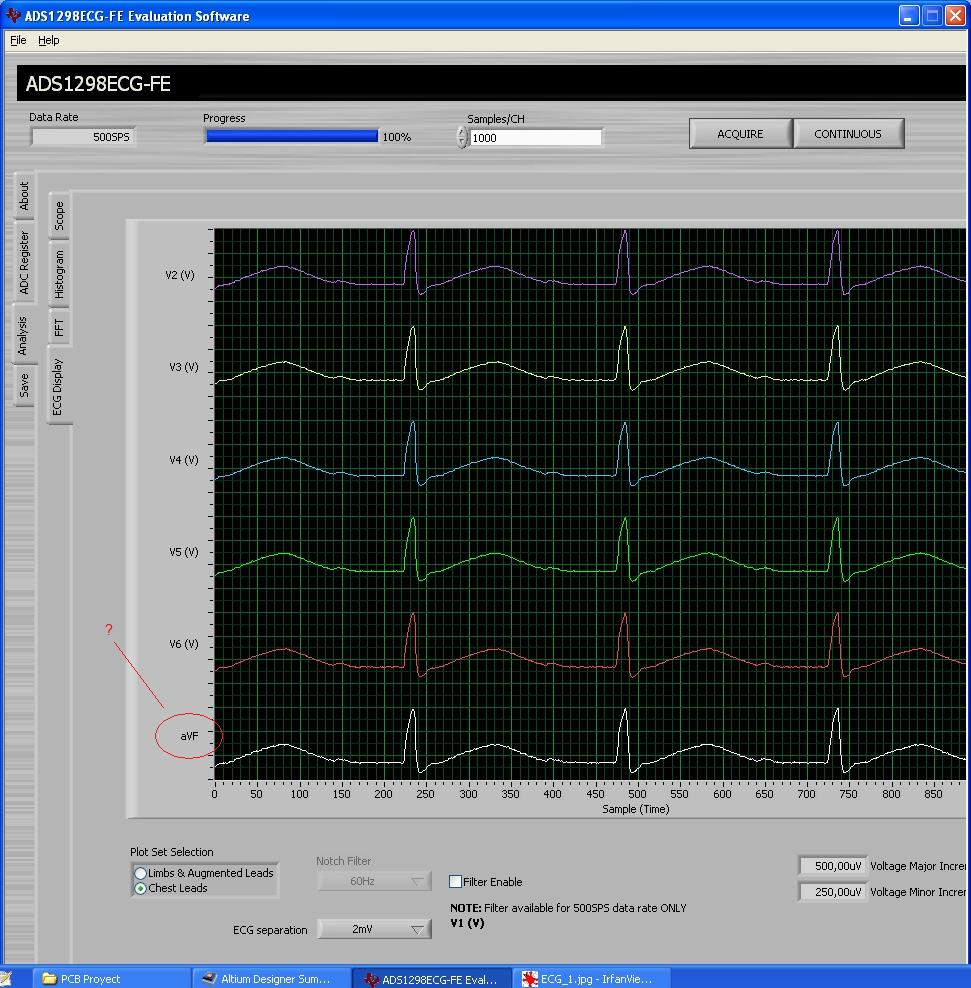

aVF is a duplicate waveform and I can't distinguish Lead III (I guess 'Lead' means 'Lead I'). Next, in the chest screen the same thing happens, missing V1(V) at the first line and showing aVF at the last one.

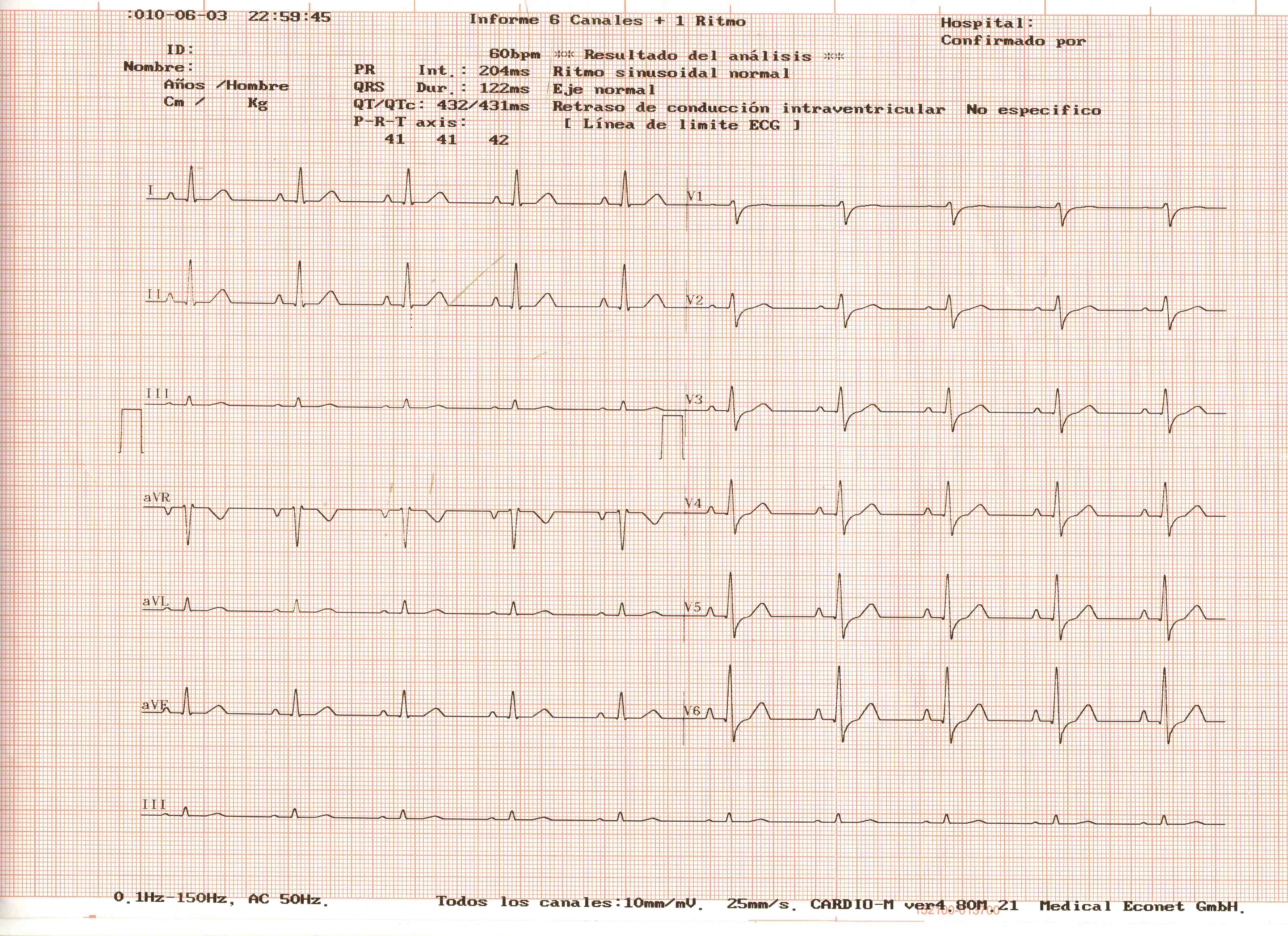

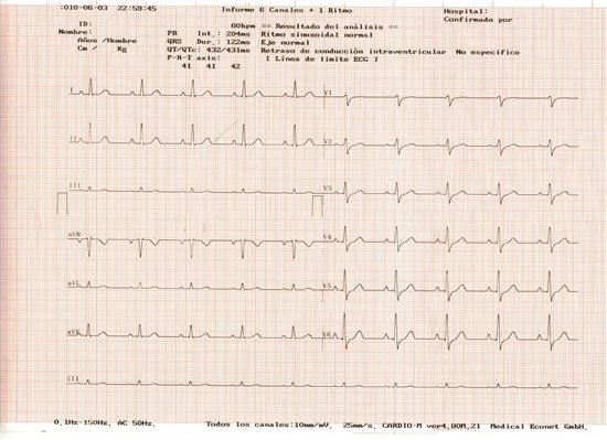

Moreover, chest signals have the same amplitude for every channel. How can is be? An analysis test performed with the same ECG simulator (all cannels) is shown here below. In this chart V1 to V6 signals have different amplitudes. Could someone clarify this topic?

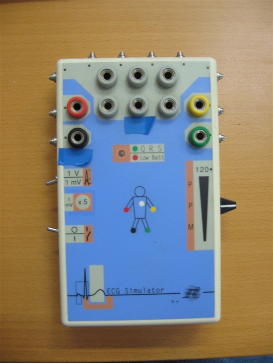

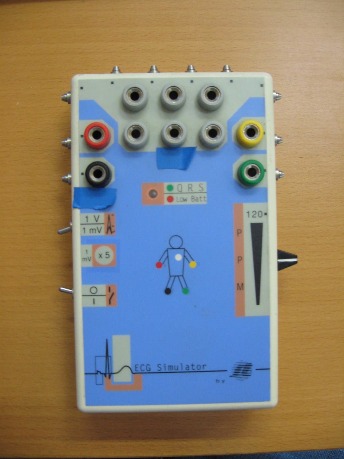

I'm using this ECG simulator:
