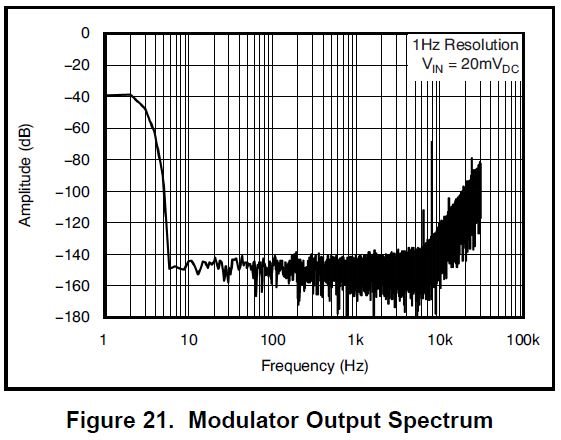

    If you look at the ADS1281's modulator output spectrum, you'll see that broadband noise is fairly flat up to about ~7 kHz:

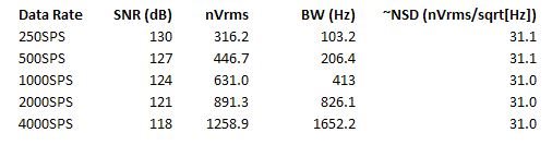

    In this region (< 7 kHz), the noise spectral density (NSD) is flat and has an average value of about 31 nVrms/sqrt(Hz). This average value comes from knowing the SNR and bandwidths (BW) of the ADS1281 for each for the digital filter settings. I did the following calculations in Excel and found the average NSD:
    ...Knowing this information, simply take the square root of the bandwidth of your digital filter and multiply it by 31. nVrms/sqrt(Hz) to estimate the RMS noise that will pass through your digital filter.
