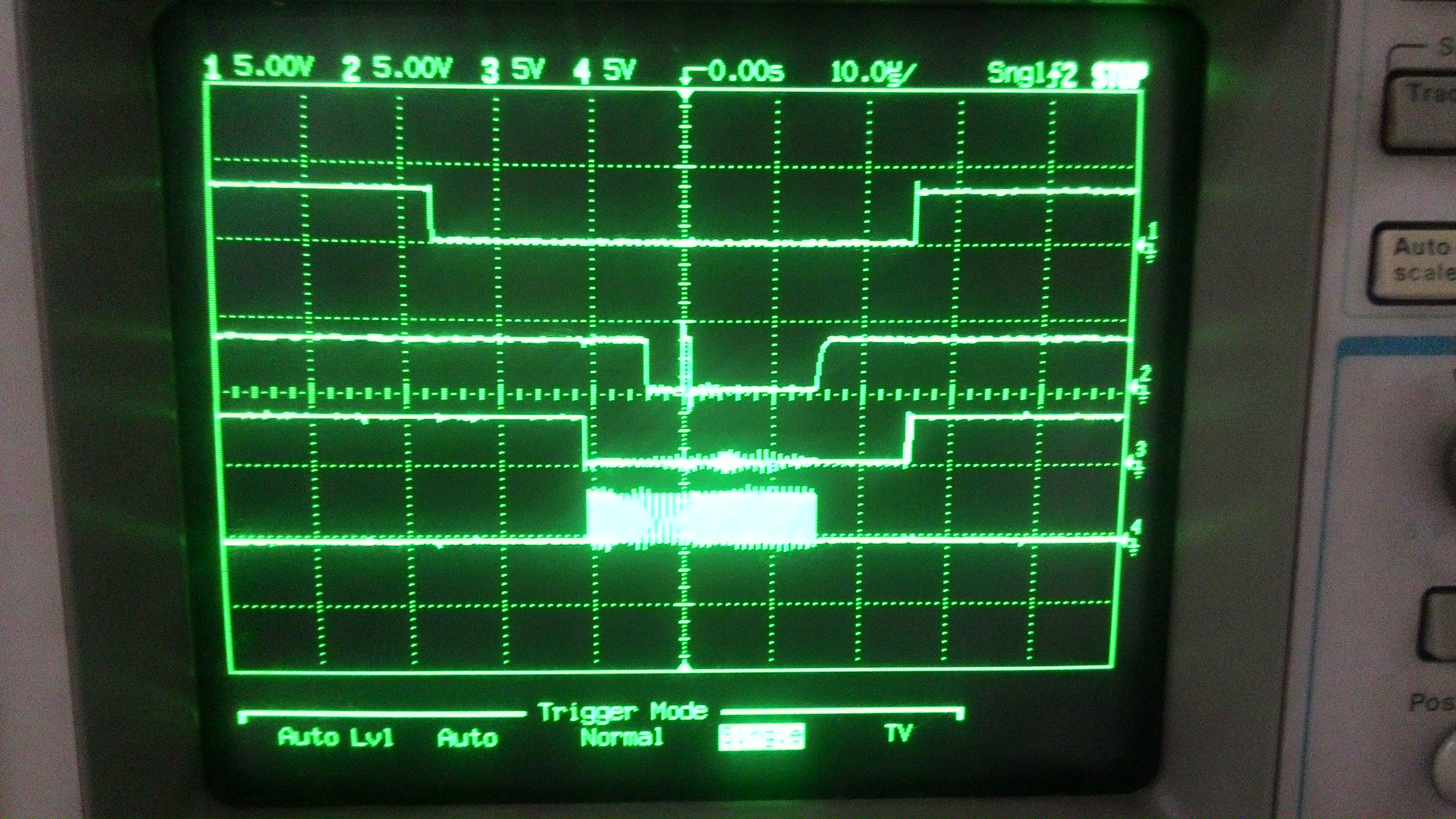

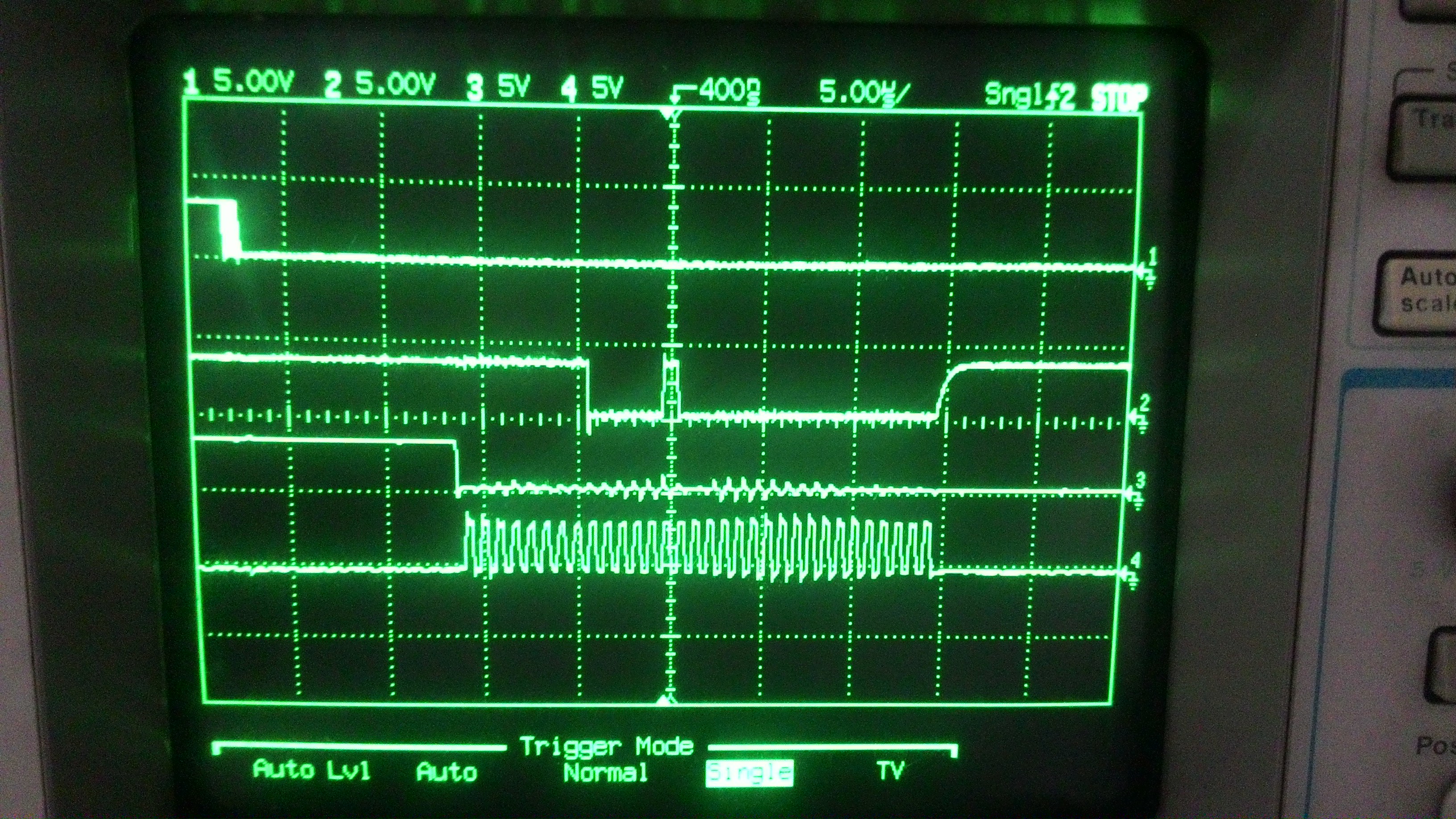

    I've hooked up the MISO line to an oscilloscope while my code is running in a loop of transmitting zeroes. I needed to do this so that I could see the waveform since I don't have a logic analyzer, plus the "roll" time feature of the oscilloscope can only go as small as 200ms/div (I've tried using this and it's too fast to actually be able to read the bits). What I saw was consistent with the results I've gathered, a single pulse every period. I don't have a picture right now but I'll attach one as soon as possible (tomorrow around noon).

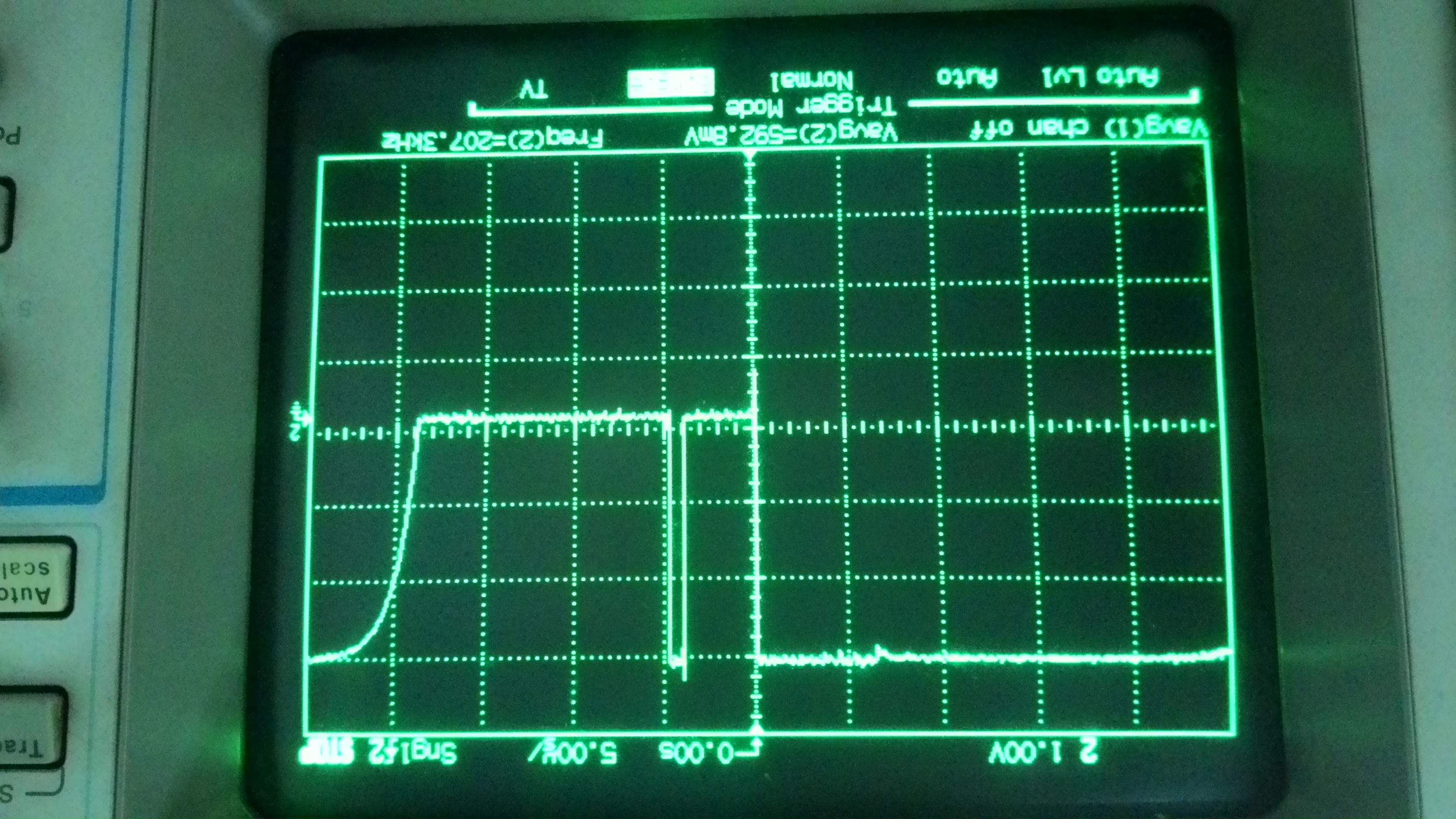

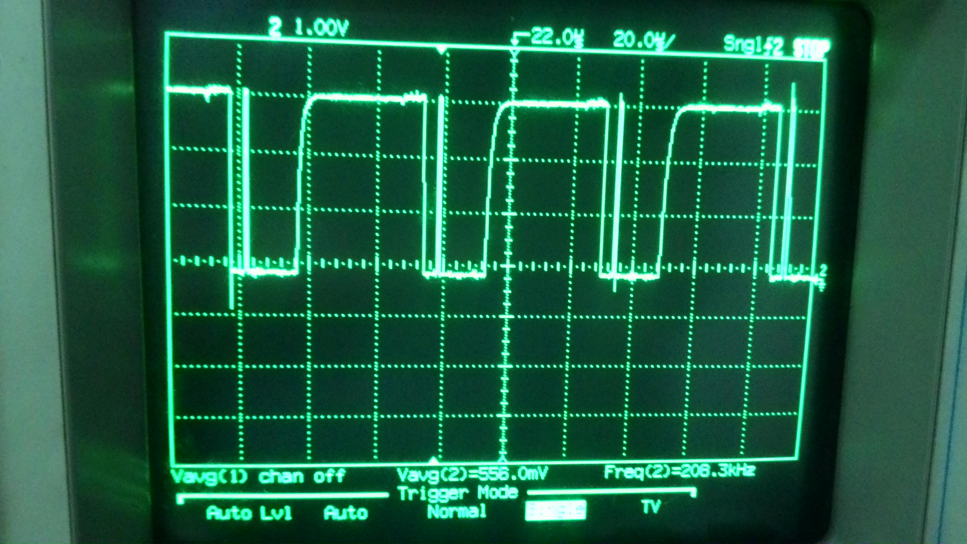

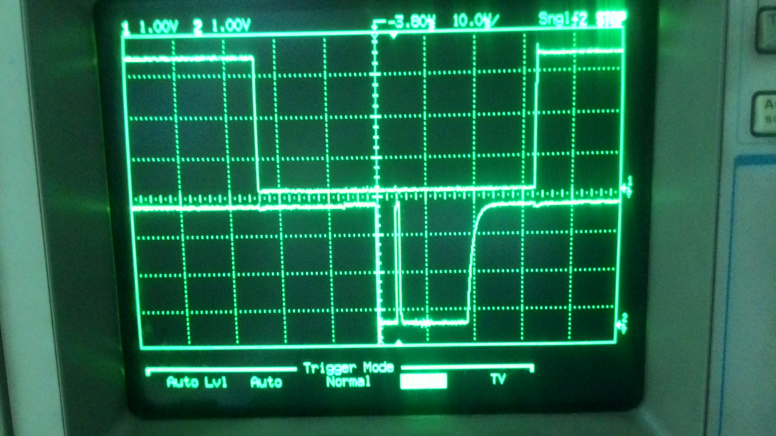

  • Hi Brian,
    You're right. My code doesn't wait for the DRDY signal, I thought it would only be relevant after I've finished initializing the chip and enabled the ADC. I'll try implementing that and see if it fixes the problem, I'll update again asap. Many thanks!
    Also, here is the MISO line as seen using the oscilloscope.
    Zoomed in to 5us/div

    Also, shown here is the DRDY line (channel 1) and the MISO line (channel 2). The results are consistent with what I'm able to read.
    Do you have other suggestions that I could try to fix this? Thank you very much!

  • Hi Brian,
    Here are the waveforms for DRDY (channel 1), MISO (channel 2), CS (channel 3), and SCLK (channel 4).
    Zoomed in to 5us/div. I can't fit the part where DRDY and CS go high, but it was shown in the 10us/div picture above that they indeed go high after a while.
    Edit: I just realized that after reading the bits that it is indeed 0xFF040000, but for some reason my code (or the odroid) reads it as 0x1. I'll review my code again and see what the culprit is. Thanks for the help!
    Edit2: But the other half of the problem still persists. I've tried sending other commands (ie. UNLOCK command) in a continuous loop but the result is still 0xFF040000. What could be the problem?
  • Hey Karol,
    It's clear that the device is sending the READY word. To understand why it will not send anything else, please capture MOSI sending the UNLOCK command (0x0655) along with SCLK.
    Brian
