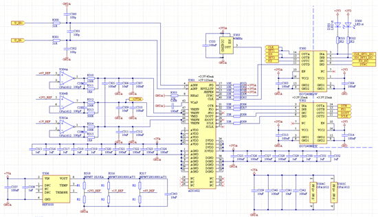

    In your schematic, you have several OPA1612s (U304, U305) listed in the circuit. Are these really the OPA2822s? Also, are they running at +5V single supply?
    I think the supplies used for the OPA2822 should be higher and bipolar. If this is not the case, the inputs of +1V and +4V would violate the input common mode range. With a +5V supply, the least positive input voltage is 1.5V and the most positive input voltage is 3.5V (see the OPA2822 datasheet on page 4). You can see the setup in the ADS1602EVM user guide in its schematic as well.
    Let me know. I'm still looking through the schematic for issues. I've seen a few small things, but this is the one that first struck me.

  • Joseph,
    That was an old schematic. The module is equipped with 2 TLC4502.
    Michael
  • Michael,
    I don't think the TLC4502 is that much better, it's input common-mode range goes all the way to the negative supply, but the highest the input common-mode range goes is to 2.7V on a 5V single supply.
    However, let's just go through some of the comments that I have for the schematic.
    1. As I'd mentioned before, the input impedance on the ADS1602 is rather low. If you an input driving the device, then the 51Ohm resistors in series with the inputs (R300 and R301) create a resistor divider to the inputs. If you measure the input at the pins as you mention, this will help you get an accurate gain error. However, it's something you'll need to consider in your system.
    2. The input impedance is also a factor for the reference inputs as well. In the reference buffer you construct, you have the same series resistance in R310, R312, and R314. This also is a factor in the gain error as well. If you are measuring the reference, then you'll also need to measure at the pins to eliminate their effect.
    3. For U304 and U305, you really should use OPA2822s. There are a couple of reasons for this. First, they were likely proven out by the development group as input buffers through testing. The bandwidth is 400MHz, which is necessary because the ADS1602 samples the input at a rate of 40MHz, or every 25ns. You need a large amount of bandwidth to get the input sampling to settle correctly. The OPA1632 and TLC4502 are likely not fast enough. Additionally, the capacitors used to supply charge in the sampling of the reference (C306, C309, C311) are very large and can make some op-amps unstable. While the OPA2822 might generally have a hard time driving a capacitive load, it has been tested with the ADS1602EVM. Again you should have a larger supply from both the negative and positive sides or the common-mode range comes up short.
