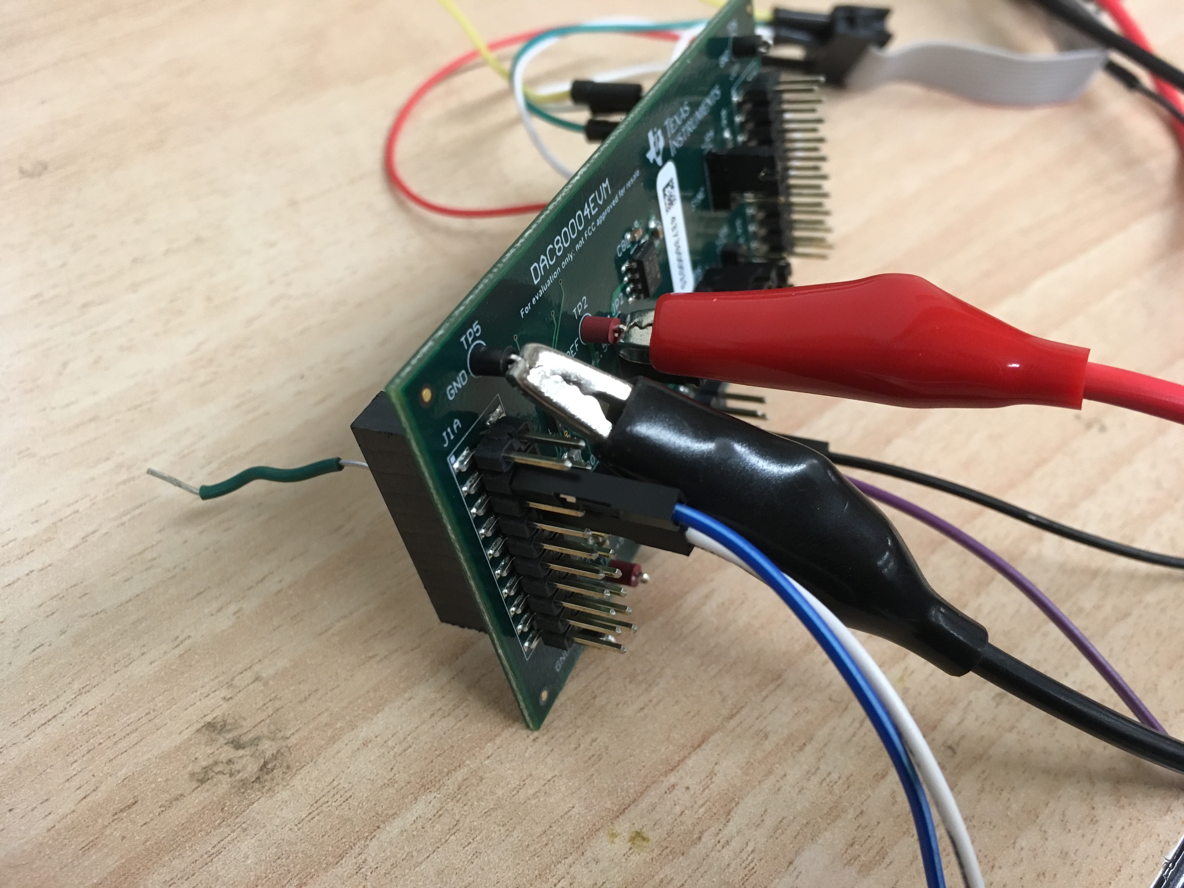

I am currently testing the DAC80004 with the DAC80004 EVM.
There are 2 strange things that i noticed and could not  be understood by me.
1) The board has a onboard 2.5V reference. But when i measured the reference voltage(TP2), I am getting 2.499V
But when i set the voltage to max. (02 0F FF FF), I am getting 2.4998 V which is higher than the reference voltage i measured, The precision 4 digital after decimal point is important to me.
If i use 2.4998 to calculate the output voltage, The output is somewhat accurate and The voltage error is maxed around 0.2mV.(Is this expected performance ?)
But if i used 2.499 to do the calculations, The error is much larger.
2) Also for the on board 5V reference ,The measured reference voltage at TP2 is exactly 5V. The max output is 5.0003V which is higher than the reference
I think the DAC meets my accuracy requirement, But i would like to know what is going on,

  • Hi Kevin, I put the VDD to be a bit above 5V, (~5.1V) to get the correct 5V reference. The ground is supplied.
    I noticed this behavior for both reference voltage, The max output is alway higher than the reference voltage.
    I supplied the power and ground from the Agilent power supply and used the Total phase USB to SPI convertor to talk to the Board.
    Other than those connections, The voltage is measured as the picture showed.
    Eddy

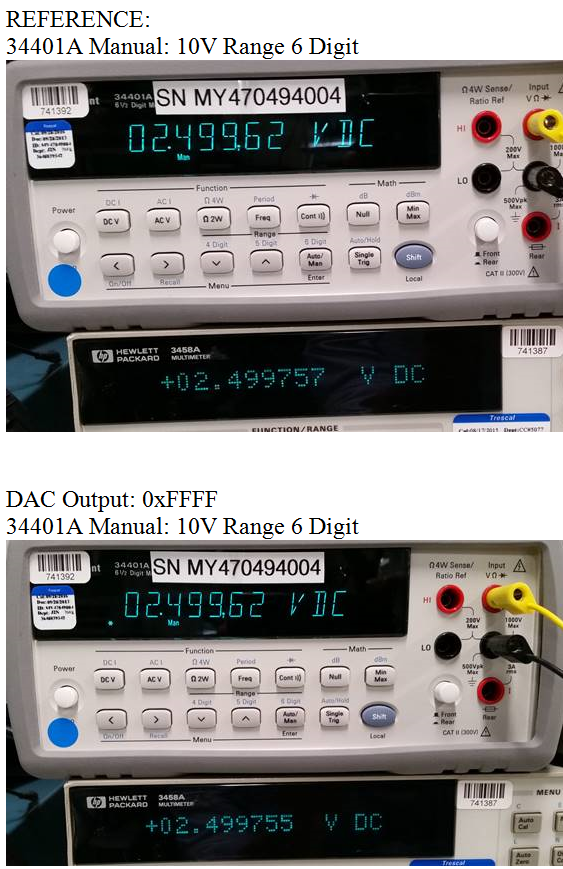

    One thing to add to the post above is that the reference is divided down within the part, and a gain stage is responsible for implementing the final full-scale range.  The errors associated with the gain stage is included in the datasheet and was described in Kevin's post above.  To restate, the full-scale error specification of +/-0.07%FSR includes this error, which does mean that for a 2.5V reference you can possibly view a +/- 1.75mV error, while a 5V reference produces +/-3.5mV error.
    I've run an experiment in our labs with the following conditions and obtained the results described and shown in the images below:
    Conditions:
    VDD: 5.1V
    On board 2.5V reference
    Cases:
    1) Measurement of 2.5V reference with both 33401A and HP3458A multimeter: (* The HP3458A PLC was increased to perform more averaging on the measured voltage giving use a more accurate result)
    2) Measurement of full-scale output of DAC 0xFFFF using both the 33401A and HP3458A multimeter.

  • Hello Eddy,
    I verified the above on 2 EVMS, both produced similar results.  To get a better understanding of your current setup you may want to switch you readings to manual and use 6 digit resolution.  Depending on where your measurement takes place, yes you may want to connect the digital ground to the board ground if measuring digital signals referenced on the EVM.
    Matt
