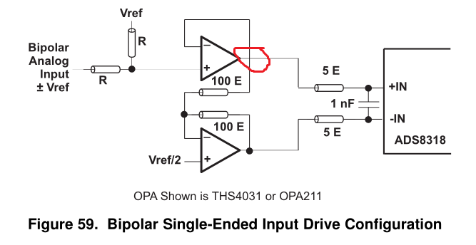

     I am using ADS8318 as ADC IC, in the datasheet, it lits one way convert bipolar single-ended to unipolar differential. But I doubt it, I think the part in the red circule lacks connection between output and negative input of upper OPA. Am I right?
