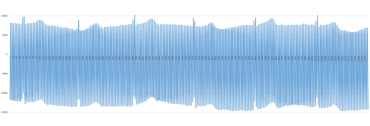

I'm having trouble with the ADS1294 on my board measuring large amounts of mains hum in the signal. As you can see in the image below, the ECG is superimposed on top.

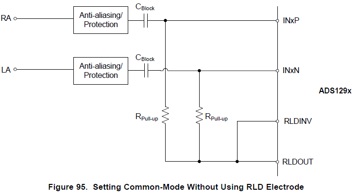

Two lead set up according to this:
with Rpullup = 3Mohms, Cblock = 1uF.

    Is the interference you are seeing at the utility frequency? Power supply coupling through electrodes is a major source of interference for ECG applications. If C_Block and R_Pull-up are not matched very well between the inputs, it could result in very poor CMRR at the inputs to the device. What tolerance is on those components?
    Brian
  • The RLD problem is solved, I was sending the command too soon after powering on the device so adding a delay fixed that. The noise is at utility frequency. The capacitors have 10% tolerance and the resistors 1%, I'll keep that in mind to go for higher tolerances on revision 2. Thanks for your help.
