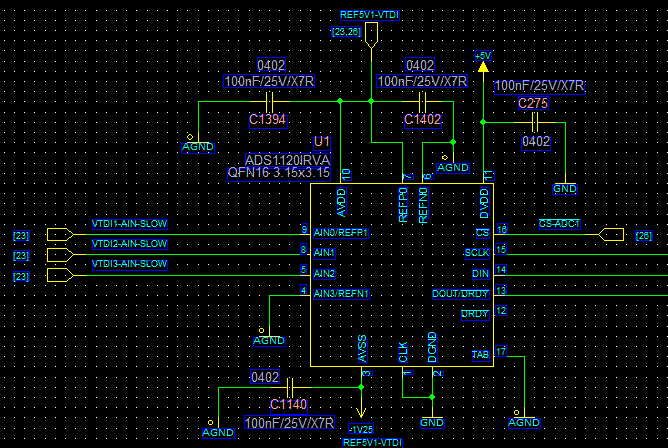

    This sounds like analog settling to me.  Do you have a schematic you can share?  Can you tell me more specific information regarding what is connected to the inputs?  The information you are now providing is much different than the information you posted previously. What are you using for a reference?

    The schematic is here:
    On each channel 1 (AIN0) and 2 (AIN1) there is connected a 0..5V signal, on channel 3 (AIN3) a signal in the range-5mV..50mV. The reference is 5V connected to REFP0 and AVDD. AVSS is -1.25V.
    Test were made by applying 1.5V separately to channel 1 and channel 2 while channel 3 has -0.25 mV. The influence can be seen on channel 3 if the 1.5V are applied to channel 2, independant of the voltage on channel 1. I see no Influence between channel 1 and channel 2.

  • Hi Ralf,
    I think what you are seeing is due to PGA overload due to operation outside the common-mode input range for the ADS1120.  One observation with respect to the supply voltages, the combined voltage AVDD to AVSS is 6.25V which is outside the recommended operating voltage even though it is within the Absolute Maximum. You have to be very careful not to exceed the absolute maximum of 7V. Transients or drift may result in a higher than expected voltage causing damage to the device.
    Second observation is related to measuring small voltages near analog ground.  This is not a trivial task, and your ground should be a plane area and also be quiet.  Ground bounce can often be an issue.
    As far as the measurement itself, three equations for common-mode must be satisfied. In the ADS1120 datasheet these equations (eq. 13, 14 and 15) are on page 21.  For your channel 3 measurement you need to be mostly concerned with Vcm minimum when using the PGA enabled.  By quick calculation using the mentioned equations, at a gain of 1 you need to have Vcm >= 0.3125 V and at a gain of 64 you need Vcm >= 0.55 V.  As your measurements are relative to analog ground, Vcm for a 50mV input signal is 0.025V which is your highest common-mode and well below the Vcm requirement.
    Even though in time your measurements may settle to a final value, they will be well outside the linear region of the PGA and therefore invalid.
