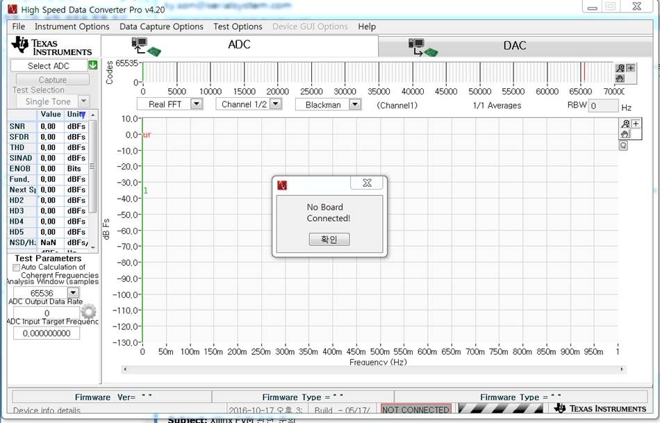

My customer is translated slac690c.zip to the Xilinx's KCU105 board.
But, It isn't connected to the HSDC pro.
Plz help me.

The firmware from slac690 does not support the KCU105. It will support the KC705 though. Currently TI is working on a release of firmware that will work with the KCU105 and plan on releasing this in the near future. We may be able to send you a prerelease version of this firmware. What mode (LMF) and sample rate do you plan on running the ADC?
