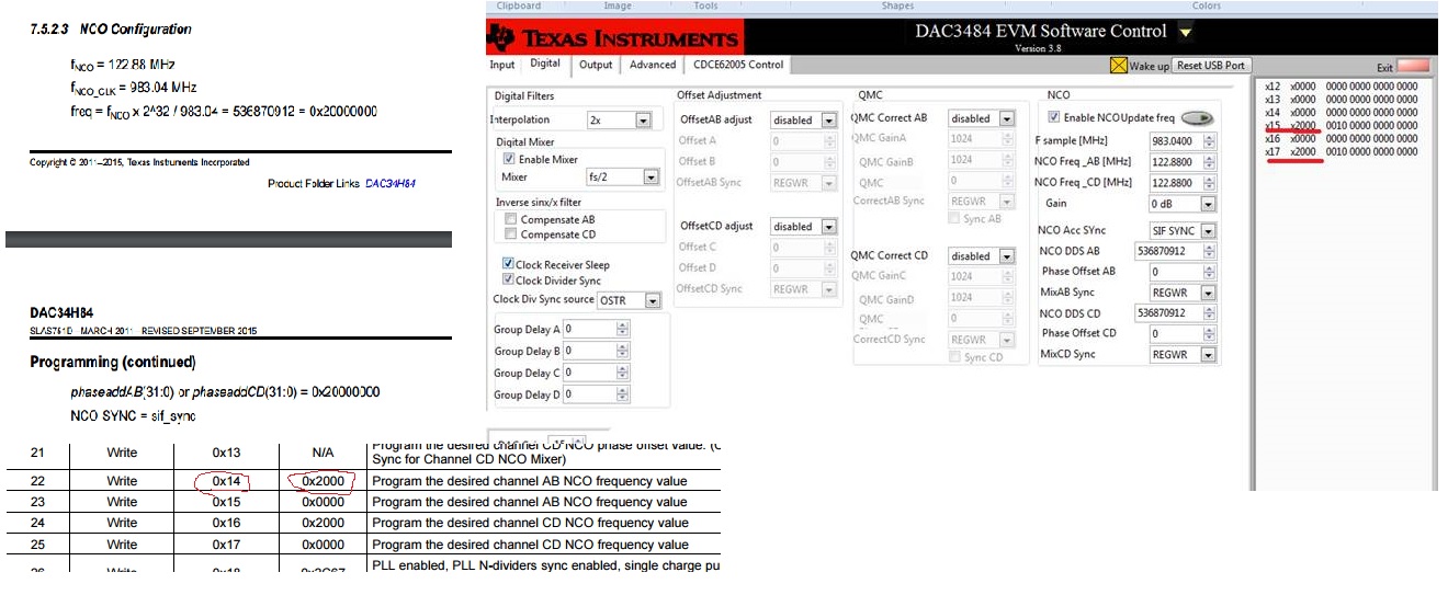

I am trying to use DAC34H84 with NCO enable mode. Wanted to offset the Input signal by 10MHz away from LO.
The FNCO _CLK is same as 983.04MHz and with Interpolation of 2X.
I found an issues between GUI and Datasheet.
Datasheet specifies to write the value “freq è 0X20000000” starting from Add “0X14”, In GUI it is different shows to write in register “0X15” should be 0X2000, which one is correct??
