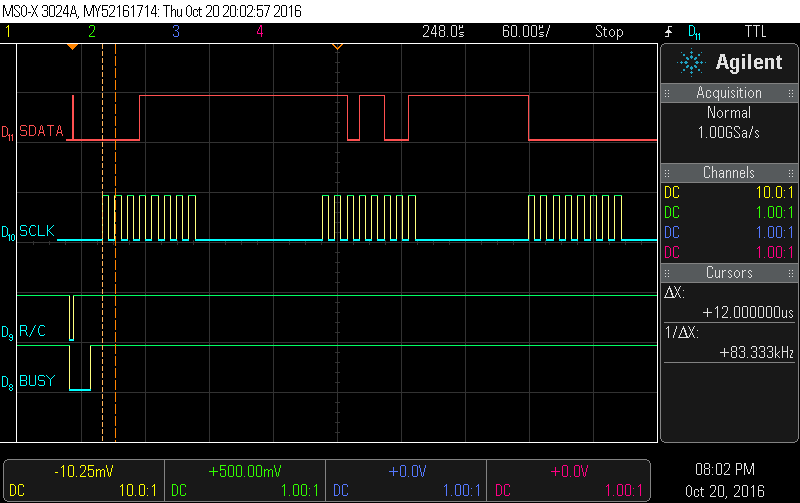

I am interfacing ADS 7825 with P89V51RD2 in serial mode. And I want to see the converted analog value on 16*2 LCD. For i have written a program but i am unable to get the proper output? I have attached the code.
Please help me out.

  • Hi Shubham,
    Can you please upload the timing screen shots for digital signals (R/C,DATACLK,/BUSY,SDATA and so on) and the schematic? these will be helpful to address the issue. Except ADS7825, ADS8684/ADS8684A may be other good choices for you which can support +/-10V high voltage input, integrate AFE, also they are 4ch/16bit SAR ADC with better performance.
    Dale
  • Hi Dale,
    I have attached the screen shot of the signals and the schematic diagram.
    The input supply is 5v DC.
    regards,
    Shubham
