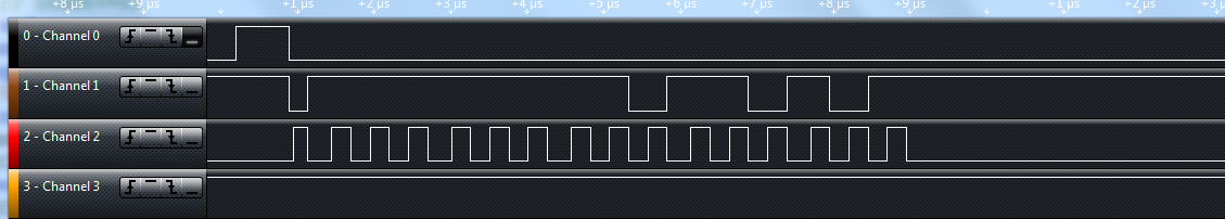

the data that depart from the base line isn't my expectation,and the analog input is just one value.
An ADC will have a DC code spread for a given analog input voltage. Please refer to Figure 14 and Figure 15 on Page 11 of ADS8860 datasheet.
Vref should be driven with a low noise and low output impedance driver.
As shown in datasheet, you could use the composite amplifier recommended on Page 33. You could also use REF6033 which is a low noise voltage reference with an integrated reference buffer.
