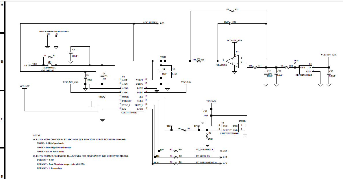

    This is the schematic Im using on the board with the ADC. For some reason I still don't undertand, the DRDY pin is in low with some noise and its supposed to be in high no? IS there any problem with this configuration??
    I tried to use it connecting the MCU PWM on the input in order to make some test but the interrupt to the MCU is not happening because the pin DRDY is on low and well... I don't know what could be wrong...
    Thanks!!

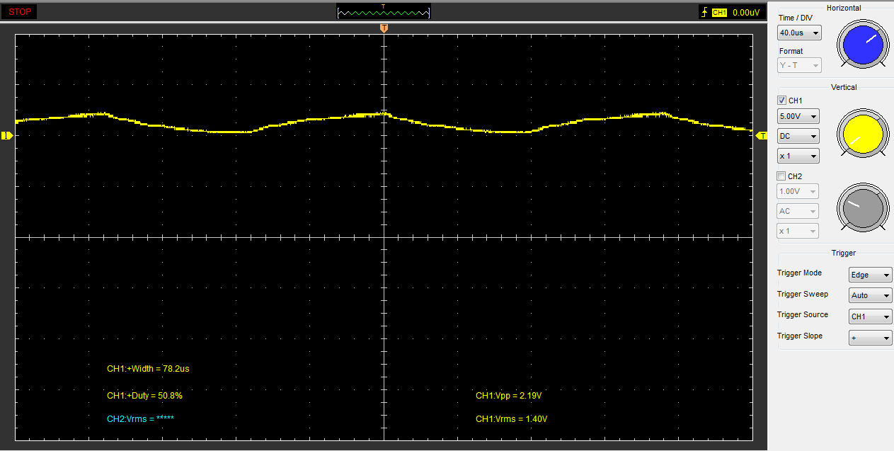

    I was doing some meassures and this is what I saw on TP12 (the MODE pin)
    is that normal? the pin is not connected to anything, since the Datasheet said "float" we assume that that was correct...

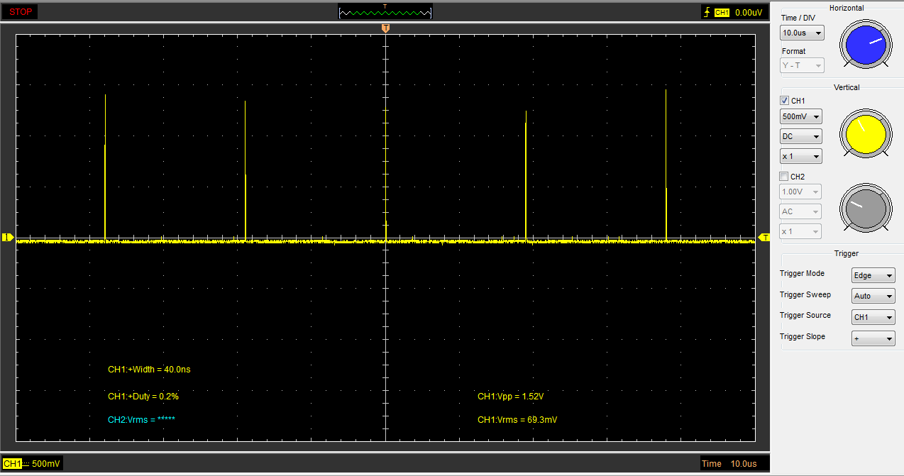

    And the TP8 (DRDY pin) this is what I have
    so... I don't know why Im having this if the format is already selected and everything... whats going on?

    In the schematic, you show a 27MHz clock, so the expected data rate is 52.7kSPS. The /DRDY pulses that you show above appear to occur at the correct interval (1/52.7k = ~19us). The reason that /DRDY is idling low between conversions is that you are not reading the data and therefore, you are not sending SCLKs. This behavior is described in Figure 63 on page 25 of the ADS1271 datasheet.
    Regarding the waveform that you see on the MODE pin, it's difficult to say for sure where this is coming from. It may be coupling from elsewhere on your board, or perhaps this is due to some RC network connected internally to the pin that is charging/discharging. Whatever the case may be, you have configured the device correctly for High-Resolution Mode. As long as you are getting consistent /DRDY pulses, then the modulator and digital filter should be operating without interruption.
    ooooh now I get that image hehe so the DRDY is working properly
    According to an answer you gave in this post and also the datasheet:
    Wouldnt I have problems with the setting time of the ADS with the changes of MODE pin?
