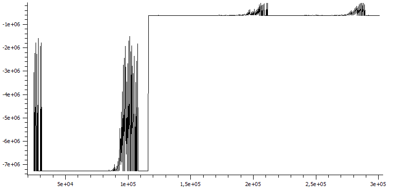

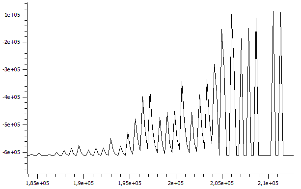

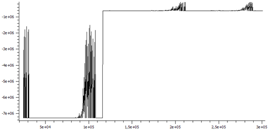

    Yes, the data varies with the timing of the read. Input is from a transimpedance amp with DC applied.
    See below for sample data (x ms, y ADC values). The input was manually changed at 340. Gain is 128. There are four channels measured, so the rate for this channel is 15 Hz / 4.
    The error looks like this

    The error is clearly triggered by the delay in polling DRDY. While the delay problem may be fixed in the future, it should not cause a problem reading the ADC. The error increases with the delay. Through DSYNC, it would be expected that there is no filter settling error after a mux change (or any other timing-related error for that matter). I'm not certain that what I see is the filter settling error. Another source of error may be a "race condition" where after polling the #DRDY flag (low) the result register is read, while a new conversion has finished and the register is being updated.
    Another behaviour that I have no explanation for is that every other channel (0-4, 1-5) seems to have a similar error just with a different sign.

    I haven't had a chance to read through your entire post, but one other thing that might help is if you had the raw data for the reads that gave you the data plot. When I say the raw data, I'm referring to the hex values coming out of the converter when data is being written.  I'd also like to know the input value (I'm assuming it's pretty close to the y-axis of the plot), the reference value and the gain of the PGA.
    If this is an error in the read associated with missing the DRDY, you might be able to track it down with the data itself (or even capture it with the oscilloscope). In the data, you'll be able to see patterns in which the DRDY is missed and the data output starts again. Just as an example, after the 8 read bit, the following 16 bits look like the start of another good read and the bits look like a run-on in data.
    In the case of negative input (like yours), the data errors would always make the error more positive and with a positive input, the errors would make the error more negative.
    Also, in your case, the errors appear to be localized within certain times in the sequence, which also may be caused by an error in timing. If that were the case, you might be a small amount off in time for the reading but set to a reading every x seconds. Also, the readings would get worse over a set of readings and then correct for itself as the timing error goes through the time when the data is being read with 24 SCLKs. This might be related to the amount of time it takes to read 24 bits of data compared to the data rate. If you continue with the reads, do the errors occur basically periodically?
