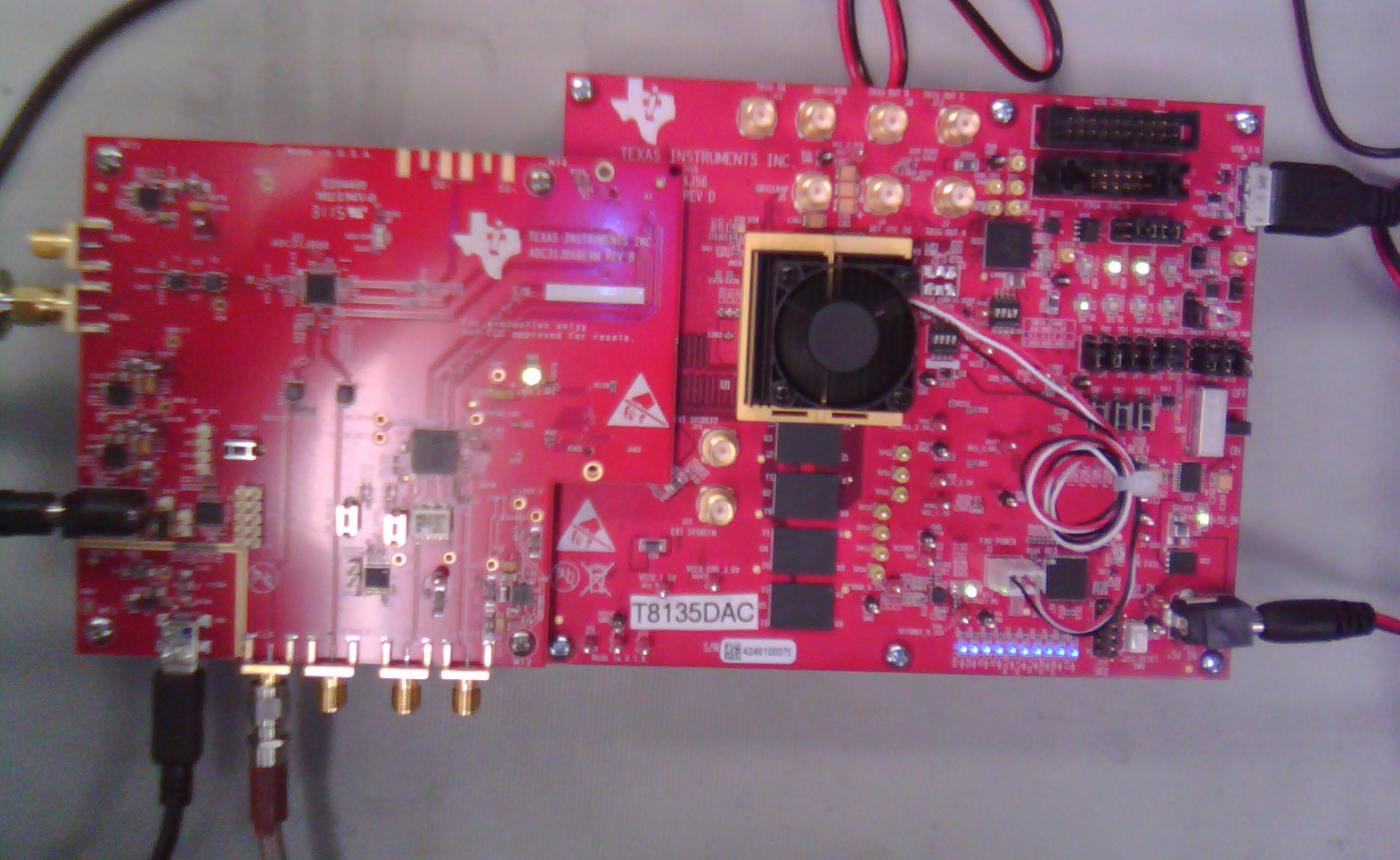

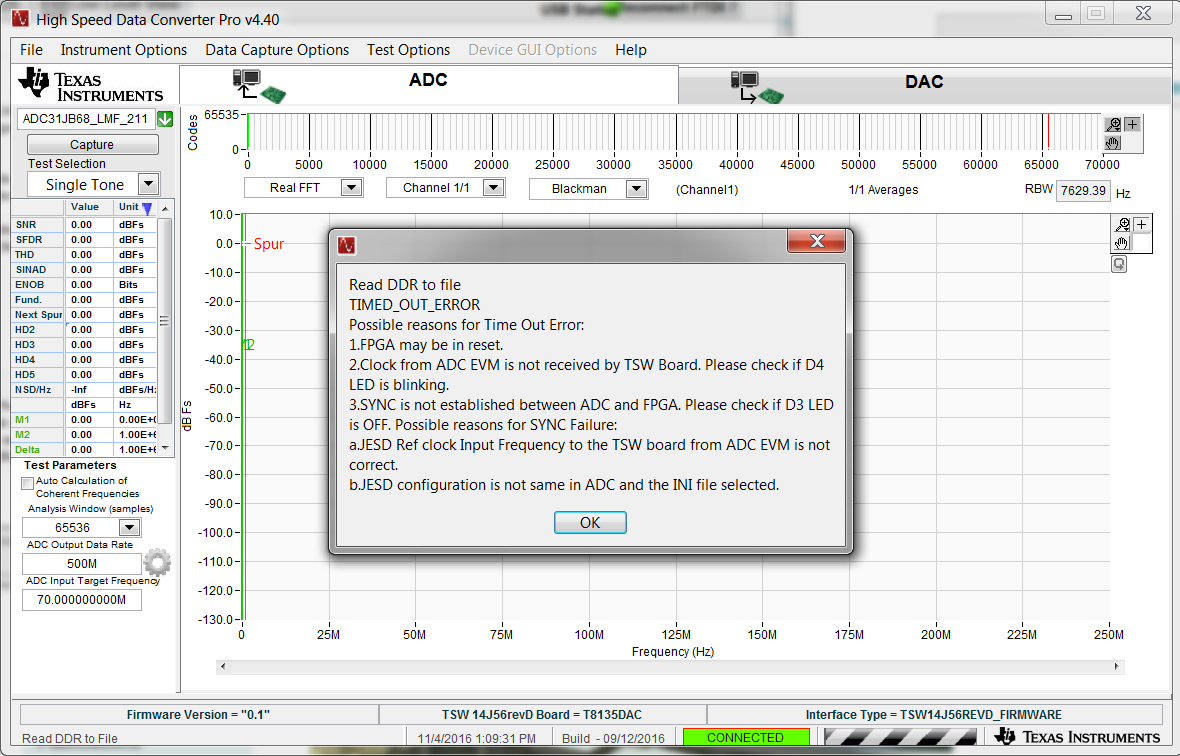

I'm using the ADC31JB68 EVM with the TSW14J56. I follow the instructions step-by-step and receive the following error:
I've also attached a picture of my board setup after I receive the error. You'll see what LEDs are on (the RX CLK LED is blinking). I appreciate the help in advance!

    > Are you following the ADC EVM setup procedure and using the Program LMK04828 button and Calibrate ADC31JB68 buttons to set up the board? (The Demo One-Push Setup button should accomplish the same steps).
    That is correct. One discrepancy I did notice in the EVM User's Guide is that it says "Use the Select ADC drop-down menu at the top left corner to select ADC31JB68EVM." The only option that resembles that in the HSDC Pro tool is "ADC31JB68_LMF_211" so that is the one I'm using.

    On the TSW14J56 board Rev D once configured, prior to hitting capture:
    D1: off
    D2: off
    D3: on
    D4: off
    D5: off
    D6: on
    D7: on
    D8: off
    D28: on
    On the TSW14J56 board Rev D after I hit capture and receive a timeout error:
    D1: off
    D2: off
    D3: off
    D4: blinking
    D5: off
    D6: on
    D7: on
    D8: off
    D28: on

  • Hi Charles
    Given the LED status indicators and seeing the same issue with 2 different ADC boards it sounds like the TSW14J56EVM has a problem.
    I'll send you a private message to get your contact information and arrange to send a replacement.
