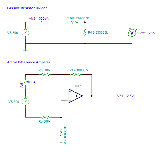

    Actually, we are designing one 6.5 bit DMM, and the input signal should been conditioned to +-2.5V, and single-ended input, due to the AD is powered by single +5V.
    - Are you trying to measure 1mV to 300V differentially, or is this the common-mode voltage range?
    It would be more common to handle this wide of a common-mode voltage, as opposed to a differential voltage. However, if this is the differential voltage, then it would need to be significantly attenuated!
    the input signal could be  differential signal, and the voltage scope is: -100mV~100mV, -1V~1V, -10V~10V, -100V~100V and -300V-300V.
    - Is the signal single-ended, pseud-differential, or a true differential signal? In other-words, what is the input voltage referenced to?
     the input signal is connected to the AD by single-ended mode, which is shifted up to 2.5V by the AD's reference voltage.
    - Where is this voltage coming from and what is the sources's output impedance?
     the source's output impedance is unknown, but the AFE's input impedance should be bigger than 1M.
    - Is the signal a DC voltage or are there AC components in the signal as well? How much bandwidth is needed to capture the signal?
     the input signal could be DC and AC, but he bandwidth is <1K.
    - Will you need to use isolation (on the analog or digital side)?
     no isolation , but the over load protection is needed.
    - Will you have multiple input channels (do they need to be isolated from each other)?
    only one channel.

  • Hi Junhua,
    Thanks for your patience! I was looking through the TI Design library to see if we had any relevant reference designs that could be helpful to your application but didn't find anything that showed how to measure voltages up to +/- 300V or protect against over voltages that large. Therefore, please allow me to provide my thoughts on the AFE design...
    I started by looking into a few options for attenuators and after comparing some passive and active options, I think the best options are either to use a 1) passive voltage divider, or possibly a 2) difference amplifier to attenuate the high voltage signals down to the +/- 2.5V or +/- 5V range (Note: An external 5V-reference would be required to measure a +/-5V signal; however, there is a good chance you would need a higher precision external reference source in a DMM application anyways). The difference amplifier circuit would require twice as many resistors; however, these resistors are smaller values and would have lower thermal noise. On the other hand, the passive circuit doesn't have the added offset and noise coming from the amplifier. Therefore, the op-amp selection would be an important deciding factor between these two circuits:
    From there, I would likely design each input range setting circuit and provide a low-leakage, low thermal EMF relay to switch between the input circuits (or switch in the correct resistor values for the desired attenuation).
    By switching between inputs circuits, each circuit could have its own input protection circuitry designed to clamp voltages outside of the input range. Alternatively, you might consider trying to design a high voltage current-limiter that would limit the input current to some reasonable value. An example of a current limiter (albeit for a lower voltage application) can be found in the following TI Design:
