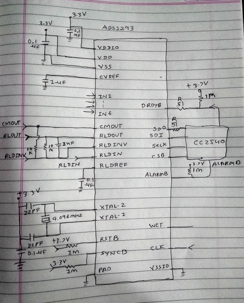

Any one got ADS1293 SPI communication with CC2540.
We want to read Revision ID 0x40 Register from ADS1293.
Lots of try but can not success to read Register.
Check CLK MOSI and CS Pin signal on Oscilloscope its Ok but not a any siganl Receive on MISO pin.

TI_ADS1293_SPIWriteReg(0x00,0x01);
int x;
while(1)
x = TI_ADS1293_SPIReadReg(0x40);
Not a any data receive in x but its still 0x00.
what is problem?? we use CC2540 and ADS1293
