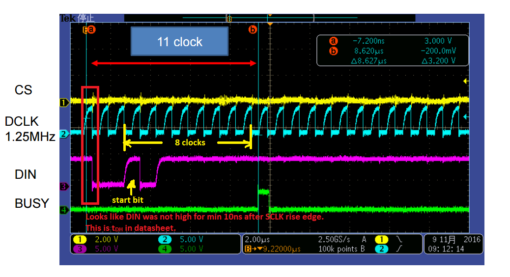

Our customer use the ADS7841.
The BUSY pulse occur at after 8 clocks.
In sometime, it occur at after 11 clocks.
Is it correct?
The configuration of the customer as follows.
 12bit conversion mode
24clocks per conversion

    Could you please share oscilloscope shots in the fault and working conditions for these pins - DIN, CS, SCLK and BUSY?

    I attach the oscilloscope shots.
    ADS7841_conversion.pdf

  • Hi Aoyama-san,
    1) I think there is a hold time violation on the DIN line with respect to SCLK. DIN should be valid at least 10ns after SCLK rise edge. Please see the image below.
    2) In this case, the device has taken clock number 4 as the start bit. 8 clocks after this edge BUSY goes high. Hence the observation that BUSY goes high after 11 clocks.
    3) You could try the following things
    a) Launch SCLK sooner than what it is right now. Or you could delay DIN by 100ns. This will fix the hold time violation.
    b) You could slow down SCLK.
    Please check if this helps.

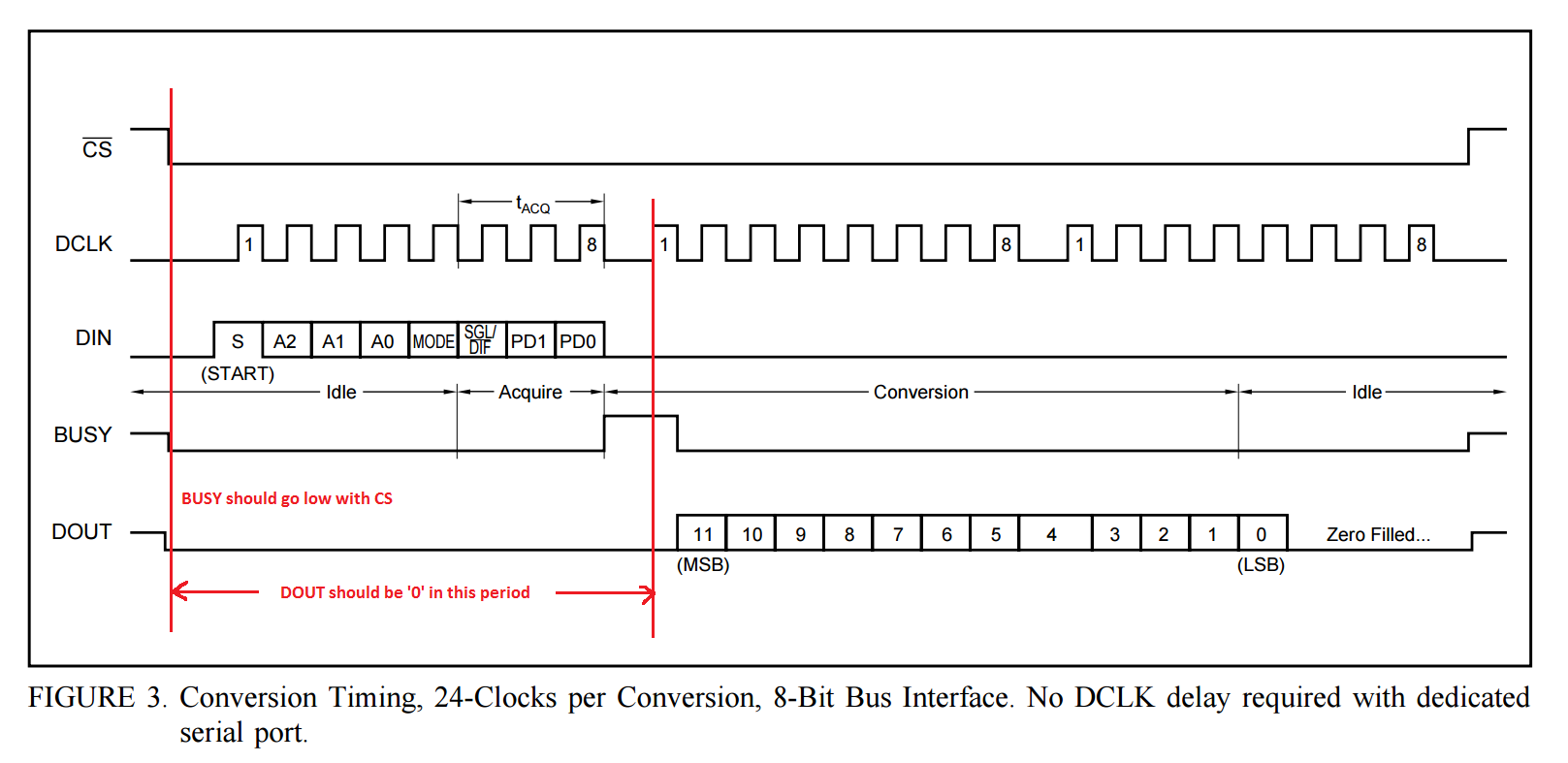

  • Hi Aoyama-san,
    The control byte starts when it detects the "first" high bit on DIN. This is the description of "S" bit.
    Hence, DIN must be held low during start of frame i.e. CS falling edge.
    If we refer to Figure 4, it can be seen that DCLK can be high or low at CS falling edge, however DIN has to be low. I understand that this aspect is not very clearly highlighted in the datasheet, unless we specifically refer to Figure 4 and notice DIN.

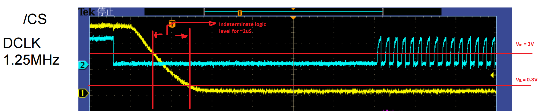

    When the CS is High to Low, the BUSY pin remain High.
    I'm worry a slow rise and fall edge is OK.
    The customer use a pull-up resistance as 4.7kohm like I2C communication.
    Is it OK?
    Naoki Aoyama
  • Hi Aoyama-san,
    As you pointed out, the digital interface is misbehaving because the CS pin is remaining in indeterminate state for too long. If you notice the timing on CS pin, it is indeterminate for over 2us.
    The pull-up resistance on CS pin should not be a problem as long as the driver is able to drive the capacitance on the CS pin trace on the PCB.
    Looking at the CS falling curve, it almost seems like there is a large capacitance or resistance on this pin. Or alternately, the pin is not being driven low, it is being floated. As other digital pins do not have such a slow slew, could you please confirm as to how the CS pin is being driven?

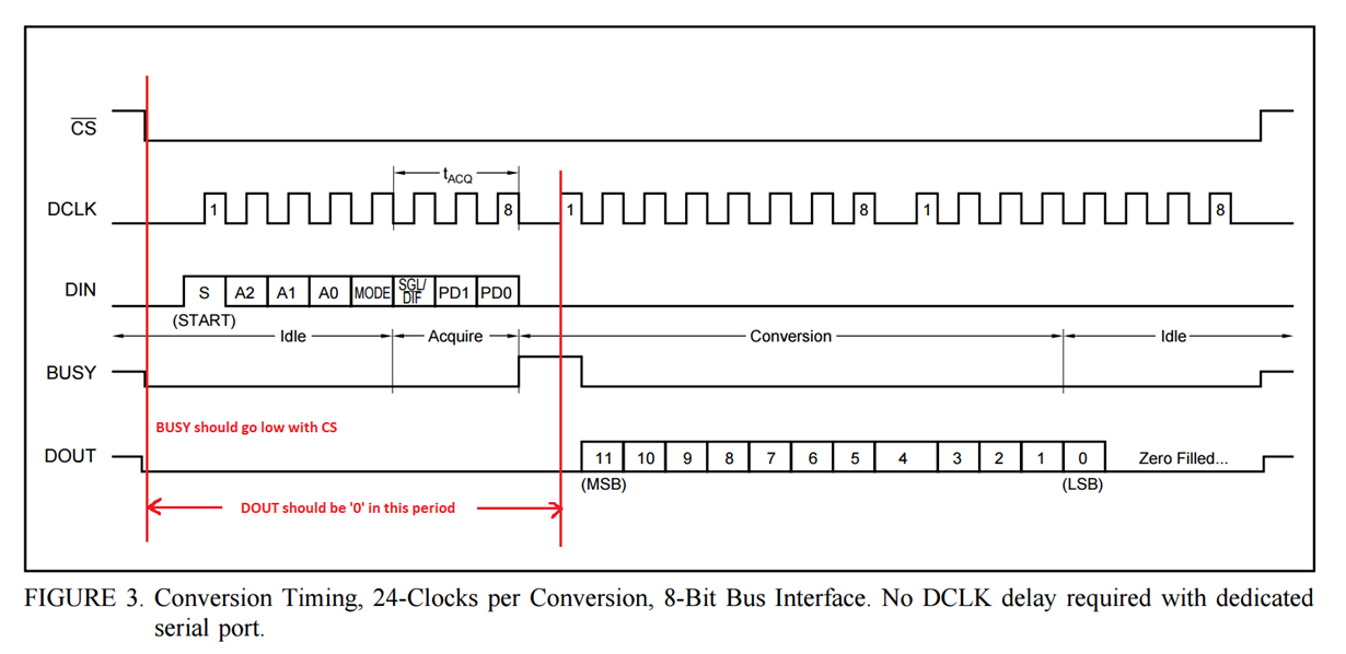

  • Hi Aoyama-san,
    Thanks for providing the oscilloscope plots.
    The device timing is expected as shown in figure below,
    1) BUSY should go low along with CS. In the plots which you sent, BUSY is going low with first high bit on DIN. This is not expected.
    2) DOUT should be at logic 0 during the first 9 SCLKs. In the plots which you sent, DOUT is toggling in this period. This can happen if you operate the interface as shown in Figure 6 of the device.
    Could you please capture the oscilloscope plots in the following configuration,
    1) Capture two conversion frames.
    2) Ensure DIN is low when CS is high. Default state of DIN should be logic 0. DIN should toggle as per Figure 3 of the data-sheet.
    3) Ensure DCLK is low when CS is high. Default state of DCLK should be logic 0.
    4) I noticed, there are 25 SCLKs being in the conversion frame. Could you please change that 24?

  • Hi Aoyama-san,
    I am sorry for the delayed response as I was away for a while.
    The timing diagrams in the datasheet are not very clear about what to expect on SDO when command frame is being sent on SDI prior to a conversion start. Hence it is best you ignore the SDO line during this period i.e. the first 8 clocks.
