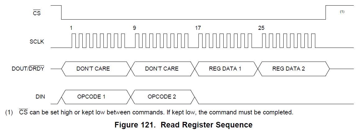

    I tried reading configuration registers of ADC to check ADC configuration. While reading configuration register initially one extra byte is received, But ADC should send REG DATA immediately after OPCODE1 and OPCODE2
    as per Figure 121. Read Register Sequence of ADC data sheet.

    Here the FSCAL[2:0] registers are set to "40 00 00", when they ought to be "00 00 40", since the first byte in this sequence corresponds to FSCAL0. With this setting, you are multiplying the ADC's output result by 0.00001526 V/V. Hence, 1.25V becomes 1.25V * 0.00001526 V/V = 0.0000768 V (which corresponds with the data bytes you're reading: "00 00 40 29"). If you set the FSCAL registers back to it default settings, you should see an output result much closer to 1.25 V.
    Regarding the extra "00" byte, keep in mind that the "RREG" command requires two bytes: <RREG + Addr> <Number of registers>; therefore, data doesn't appear until the third byte. Perhaps, the "00" is the output byte while you're still sending the <Number of registers> byte?
    I am sending <0x21> and <0x13> , which means from power register 20 configuration bytes are interested to read .
    Below are complete write and read packet :
    Sending: 21 13
    Receiving: 00 00 00 01 05 44 60 0F CC 00 00 00 00 00 40 BB 00 00 00 00 00 00 00
    Here first two zeros are received during transition of <RREG + Addr> and <Number of registers> (which is expected ), however 3 zero is extra byte received and sometimes some garbage value also is received at 3r byte instead of zero . But 4th byte on wards proper configuration data is received every time.
    IS ADC required one extra Clock cycle to process the received command before transmitting data?

    Regarding your other issue with reading an extra data byte:
    You're sending the correct command sequence, so there shouldn't be an issue. The ADC does NOT need an extra byte to process the command, as shown in Figure 121 of the datasheet:
    Have you tried looking at the SPI bus with an oscilloscope?
    I suspect that the communication is okay, however, you may be running into an issue with your MCU. Many MCUs implement an SPI buffer and, if not cleared out, you may have an extra byte (or bytes) left over from the previous SPI transaction. You may need to read from the SPI buffer with EVERY byte sent (even for command bytes when the communication is not full-duplex) to ensure that the buffer does not hold on to those junk bytes. Otherwise, you may need to clear the SPI buffer before starting another command sequence.

    In this case you may be sending an extra byte after reading the previous data...
    The ADS1262 will REPEAT the data output sequence, starting with the STATUS byte. Therefore, you may be getting the STATUS byte into the SPI buffer on the previous reading. Then when you go to read data again (without first clearing the SPI buffer), you will get the new STATUS byte and the data, so the MCU acquires two STATUS bytes in a row.
    Does that make sense?
    Chris
  • Hi Chris,
    You are absolutely right.
    Now able to receive exact ADC data as per data sheet without any extra byte, after clearing SPI receive buffer (before transmitting new command).
