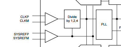

I don't fully understand the role of the SYSREF signal in the ADC3423
Is it needed only for part to part synchronization? If i have only one ADC can I leave the SYSREF pins open?
Is there a way to synchronize multiple ADC's without sysref?
The internal drawing in the datasheet is not clear. I don't undertand the direction of the lines. Is the sysref goes in or out from the divider? can you show a more detalied drawing with explanation?

    Yes it is similar to a sync. It can be used to reset the counters and dividers in the device if you want to do some synchronization. It is not the same function as JESD204B.
    If you do not need this, please ensure that it does not float as this could cause some issues with noise causing a logic transition which will reset the device and cause glitches. Normally you can tie this to a static logic level (M to gnd and P to DVDD) or disable the SYSREF BUF in the register map.

    Where can I find more information on the sync method? Timing between sync signal and counters/dividers reset? Any timing diagrams? application note? Which dividers and counters are being reset?
    Can you please elaborate on the drawing I've attached in the previous post?

    The SYSREF will reset the divider so that the divider output will be the same phase across multiple ICs.
    If you are not using the divider or not trying to do multi chip synchronization then you can just disable the SYSREF BUF.

  • Actually I am intending to synchronize 3 adc's, so any information regarding this issue will help.
  • Izik,
    Just ensure that you match the clocks, SYSREF and data lines to each ADC. Also ensure that your SYSREF signal meets setup and hold times as defined in the data sheet. This will ensure that you can synchronously reset each of the ADCs.
