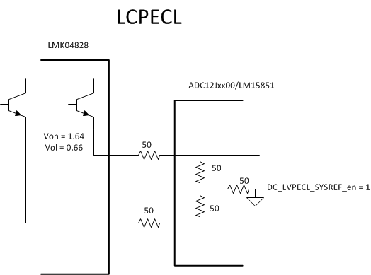

My customer has a question about ADC12J4000.
[Q1]
Please tell me how to configure DC Coupled SYSREF between LMK04828 and ADC12J4000.
Is my understanding correct ?
<My understanding>
  • Set the SYSREF output in LMK04828 "LVPECL 1600mV"
  • connected directly between SYSREF output in LMK04828 and SYSREF input in ADC12J4000.
  • Set "DC_LVPECL_SYSREF_en" bit in ADC12J4000 "1"
Hiroshi Katsunaga
  • Hi Hiroshi
    For DC-coupled SYSREF from the LMK04828 to the ADC12J4000 I recommend the following setup.
    • Connect the LMK04828 SYSREF output to the ADC12J4000 SYSREF input using the following circuit configuration:
    The series termination resistors work in combination with the ADC12J4000 internal terminations to provide the proper common mode and differential voltages needed.
    • Configure the LMK04828 SYSREF output for the ADC to LCPECL mode. This has a lower common mode voltage than standard LVPECL, so it aligns better with the ADC12J4000 SYSREF common mode input requirements.
    • Configure the ADC12J4000 SYSREF receiver to DC coupled LVPECL mode by setting the DC_LVPECL_SYSREF_en bit.
    Please let me know if you have additional questions.
    Jim B
