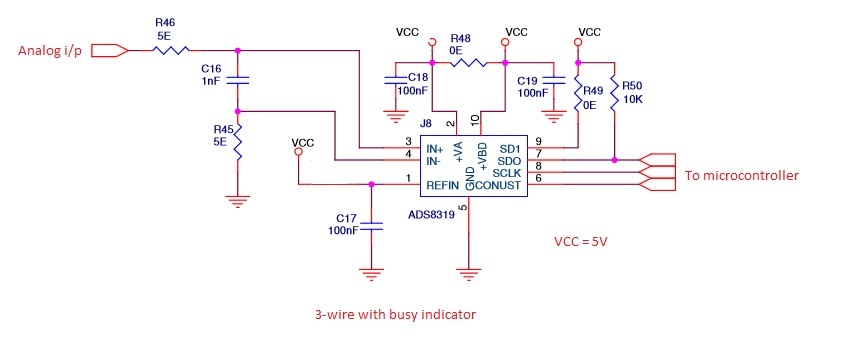

Am using this ADS8319 with 3wire with busy indicator, the schematic am attaching.
Am able to get the proper response for input analog voltage till 2.5 volts for which am getting ADC value of 32767, but if I increase the input analog voltage above 2.5V it is still giving the same value 32767.
can't able to measure voltages above 2.5V.
Vref am giving is 4.98V
please suggest the solution.
