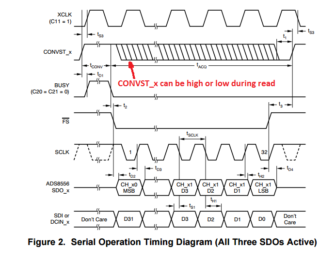

  • Hi Tachibana-san,
    You can keep CONVST_x either high or low during data read, after the conversion was completed successful.
    Please see figure below,
    Rahul

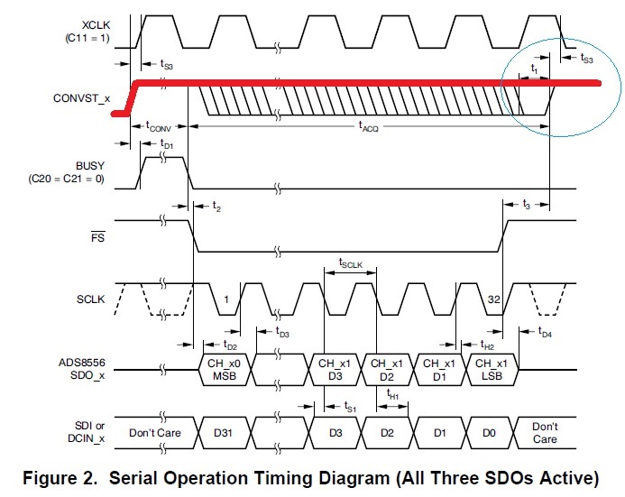

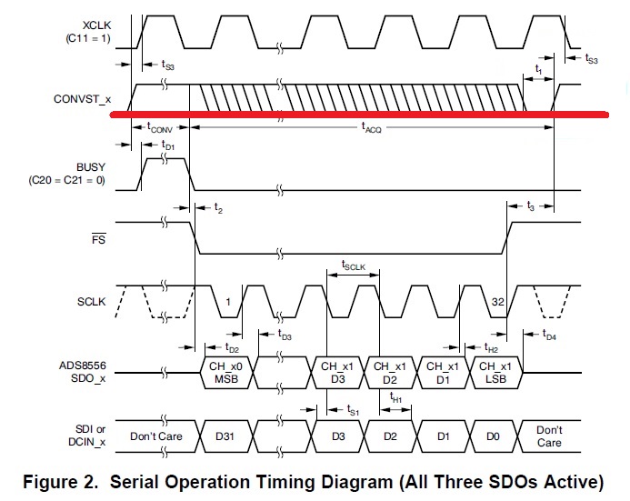

  • Dear Rahul-san,
    Thanks for your advice, and I'm sorry to my late reply.
    My explanation was insufficient.
    My question is as follows,
    1. If CONVST_x is kept to ‘Hi’ after starting AD conversion with switching CONVST_x from ‘Lo’ to ‘Hi’,
    what data will be output after enabling RD and CS?
    I think that the last result of AD conversion will be output. Is it correct?
    2. If CONVST_x is kept to ‘Lo’ after AD conversion is completed normally in the previous cycle,
    I think that the result of AD conversion of the previous cycle will be output. Is it correct?
    M. Tachibana
  • Hi Tachibana-san,
    Case 1 - If CONVST_x is kept to ‘Hi’ after starting AD conversion with switching CONVST_x from ‘Lo’ to ‘Hi
    The previous conversion result will be available when CS/RD are pulled low.
    Case 2 - If CONVST_x is kept to ‘Lo’ after AD conversion is completed normally in the previous cycle
    As shown in Figure 2, the CONVST signal is a don't care when the read operation is inititated after a successful conversion.
