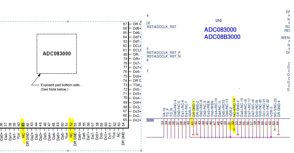

I have one question of the ADC083000.
In the datasheet, 41th pin descirbe NC. but RDK tied to the GND.
Is there any special meaning? more stable?
Jay.
Hi Joseph
The ADC083000 datasheet says to leave pin 41 as NC, so that is the recommended configuration.
As noted in that reference design document it is also OK to ground pin 41.
Having it grounded or NC will not affect the ADC083000 functionality or performance.
