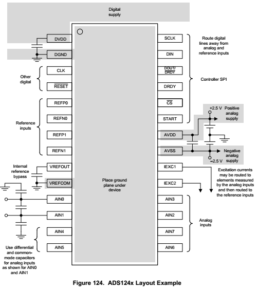

Hi expert,
Can you please explain why the datasheet suggest to place huge ground plane under device?
It seems that "Do's and Don'ts" and "Layout Guideline" do not mention that tips...

  • Kenichiro-san,
    The ground plane is drawn as a continuous plane underneath the device because it can be done easily. In general, it's good to lay out as much of a continuous plane for the ground for shielding the device from EMI and reducing the ground loop voltage. Here, it's easy to put down a ground plane below the device and route analog and digital lines in different directions from each other.

  • Hi Joseph,
    Thanks a lot! Good information! Still follow the guideline in the datasheet.
    (It's recommended to separate the analog and digital part!)
