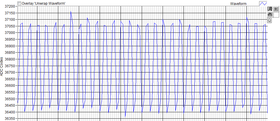

I'm using a TSW54J60EVM and a TSW14J56EVM to evaluate the ADS54J60 and the LMH6401 in DC-coupled mode.  I had to modify the analog front-end from AC-coupled to DC-coupled.  I've removed T1, change C197, C198, C18 and C24  to 0R0 (from 0.01uF series capacitors) and also change R119 to 10K (from 0R0).

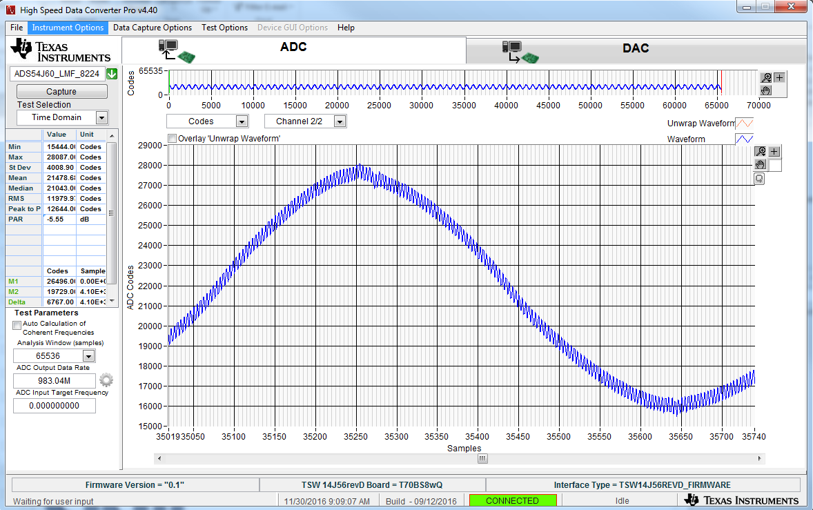

If I inject a DC signal with an amplitude of 0.60V (and over) on J3 and leave J4 unconnected, I get a strong Fs/4 spur (see attach image).  It disappears if the DC signal is lower than 0.60V.
I'm using the default scripts (i.e ADS54J60_LMF_8224.cfg and LMK_Config_Onboard_983p04_MSPS.cfg).
I've tried to modify the EN_INPUT_DC_COUPLING register (Master 80h, x4F) and Nyquist registers (Main Digital 6800h, x42, x4E).  I've also tried to connect the ADC's VCM pin to the LMH6401's Vocm pin (i.e. move 0R0 from R125 to R126).  It didn't fix this issue.
How can remove this Fs/4 spur ?

    Thanks for the link to the app note!  I've connected the ADC's Vcmo pin to the LMH6401's Vcm pin via a 0R0 on R126.  I've removed R125.  However, I still have the Fs/4 spur when a DC-coupled signal (~1MHz sinewave + 1.7VDC) is applied at J4.  J3 is terminated to 50ohm.
    At the output of the LMH6401, I've measured at DC offset of 177mV (with Vcm) on OUTP and -185mV (with Vcm) on OUTN.  It looks like the LMH6401 Vcm is shifting as the DC offset increases.
    Can you confirm the component changes to modify the TSW54J60EVM to DC-coupled?  It is not specified in the app note.   Also, the app note shows the two inputs with the same DC-offset when in DC-coupling (see figure 2 in the app note).  Well, I'm confirming that if both inputs have the same DC-offset the Fs/4 spur disappears.  It seems the LMH6401 (in DC-coupled mode) will not keep a constant Vcm when a DC-offset is present at the inputs.

    The Fs/4 spur jumps abuptly to -36dBFS when there is a DC offset. It is -90dBFs when there is no DC offset. Based on my measurements on the evaluation board, it seems that the LMH6401 output doesn't keep its Vcm to 2.1V. Vcm gets worse (i.e. output is more asymmetric) as the signal propagates thru the low-pass filter.
    IN_BM = 1.370VDC
    IN_BP = 0VDC
    OUTP - VCM = 187mVDC
    OUTN - VCM = -192mVDC
    BINP - VCM = 126mVDC
    BINM - VCM = -142mVDC
    We need the Fs/4 spur at -90dBFS when there is a DC-offset.
    Patrice

    The offset correction block only has a range of +/-15mV. If DC input exceeds this limit, the device will no longer be able to correct for internal mismatch in DC offset of interleaving cores and Fs/4 spurs will appear in the spectrum. Only way to handle this is to freeze the DC offset corrector with idle channel at ADC’s input. Then apply DC signal. To do this, follow the instructions attached.
    Jim
    ADS54J60_DC_coupling.pptx
  • Jim,
    The fix is working on the TSW54J60EVM evaluation board ! There is still a spur on Fs/4 but it is much smaller as expected. We are going to try this fix on our own prototype board.
