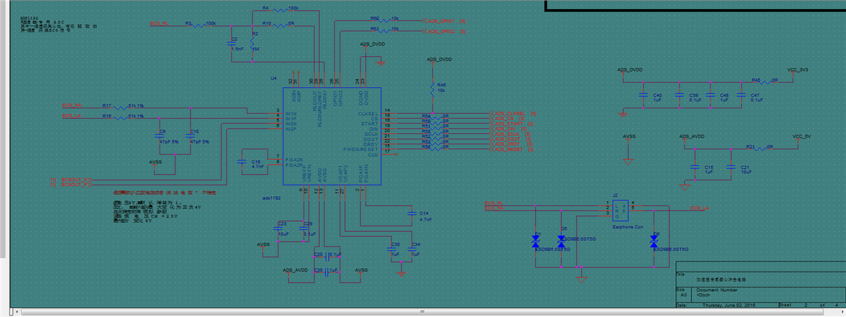

    The schematic of ads1192 is as follows. The IN2N is now connected to GND , and IN2P is connected to the output of a amplifier (TL072, also from TI).
  • Hi Xianwen,
    The input voltage to the ADS1192 cannot go below AVSS. When you say that the SE input of the sensor can swing to -3V, is that the input voltage to CH2 when CH1 is also corrupted? If so, you will need to scale and level shift the input signal so that it swings from 0 to Vref.

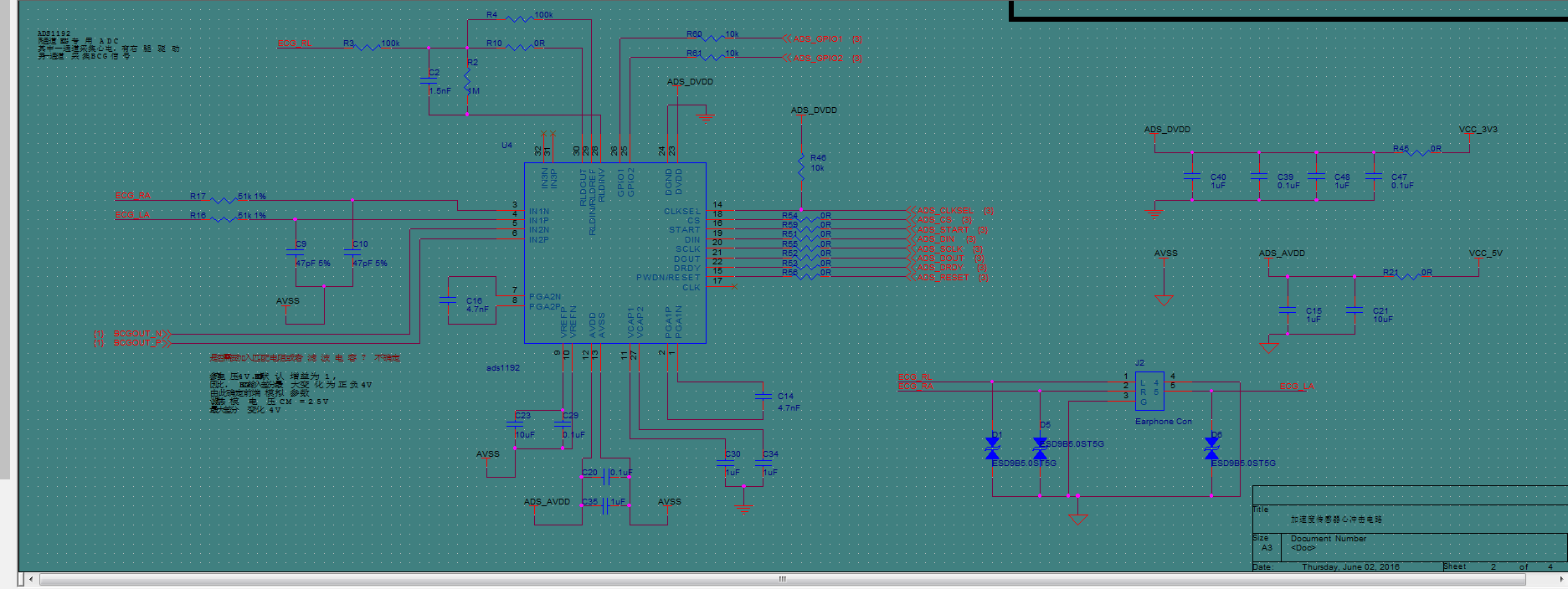

    I add a adc drive to convert the single-ended signa to deifferential signal. I measured the input of channel 2, the IN2N swing from 1.05V to 1.55V and the IN2P swing from 1.0V to 1.48V. The common mode voltage was set to 1.25V. The PGA gain for channel 2 was set to 1. The AVDD was set to 4V and the AVDD was set to 3.3V. The differential input met the requirement of ADS1192 acoording to the datasheet.

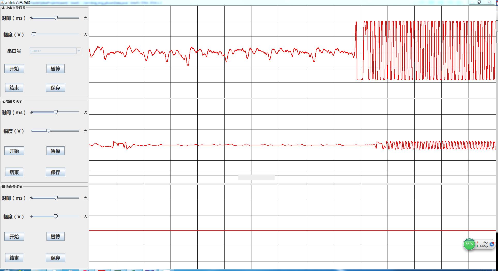

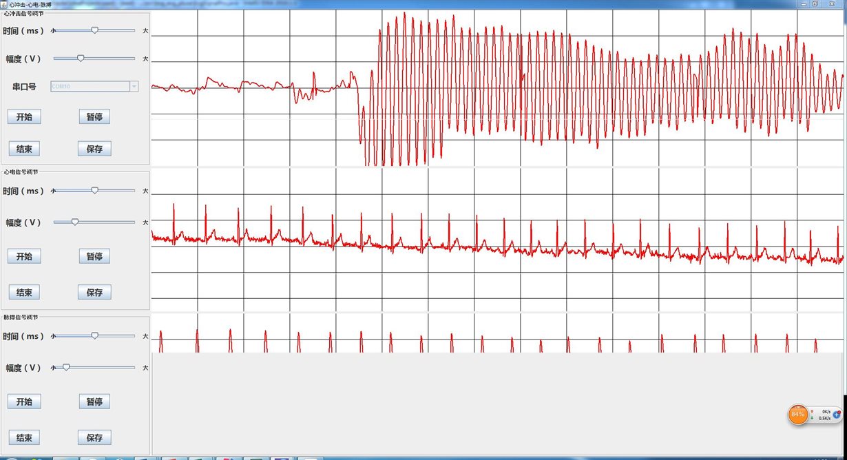

    The interference is still there! When I pressed my sensor, the signal of channel 2 was saturated and the signal of channel 1 was collapsed. See the figure below. The upper signal is from channel 2 and the lower one is from channle 1.
  • Hi Xianwen Zhang,
    If the signal at the point ~2/3rds of the way through the upper signal is the point at which you pressed your sensor, the signal is bouncing back and forth between the two limits. If it's saturating both positive and negative, that indicates you either have a problem in your code or the input is switching back and forth (i.e. oscillating). Can you send a screen capture of the actual analog input to CH2? Another possibility is that you damaged the chip if you were driving the input to -3V previously.

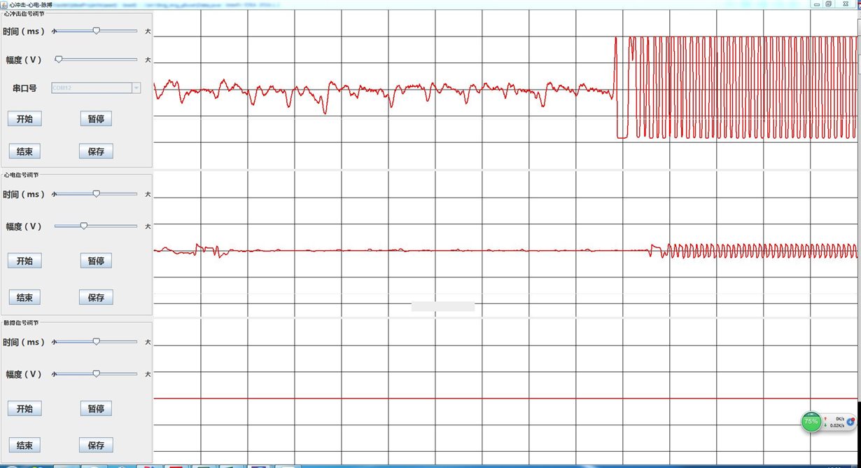

    I found that when I pressed the sensor the input of channle 1 also changed. But if I pluged in the ECG connector,  the interference disappeared. See the sample points we measured when the the channel 1 connected to the body.

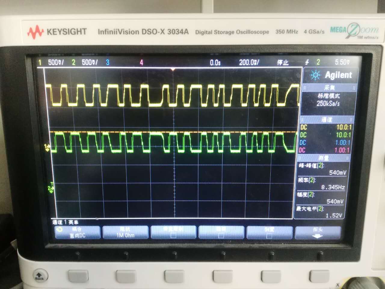

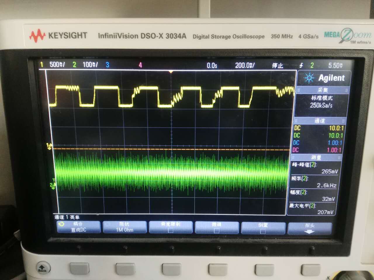

    I measured the input of the channle 2 when I pressed the sensor. See the figure below.

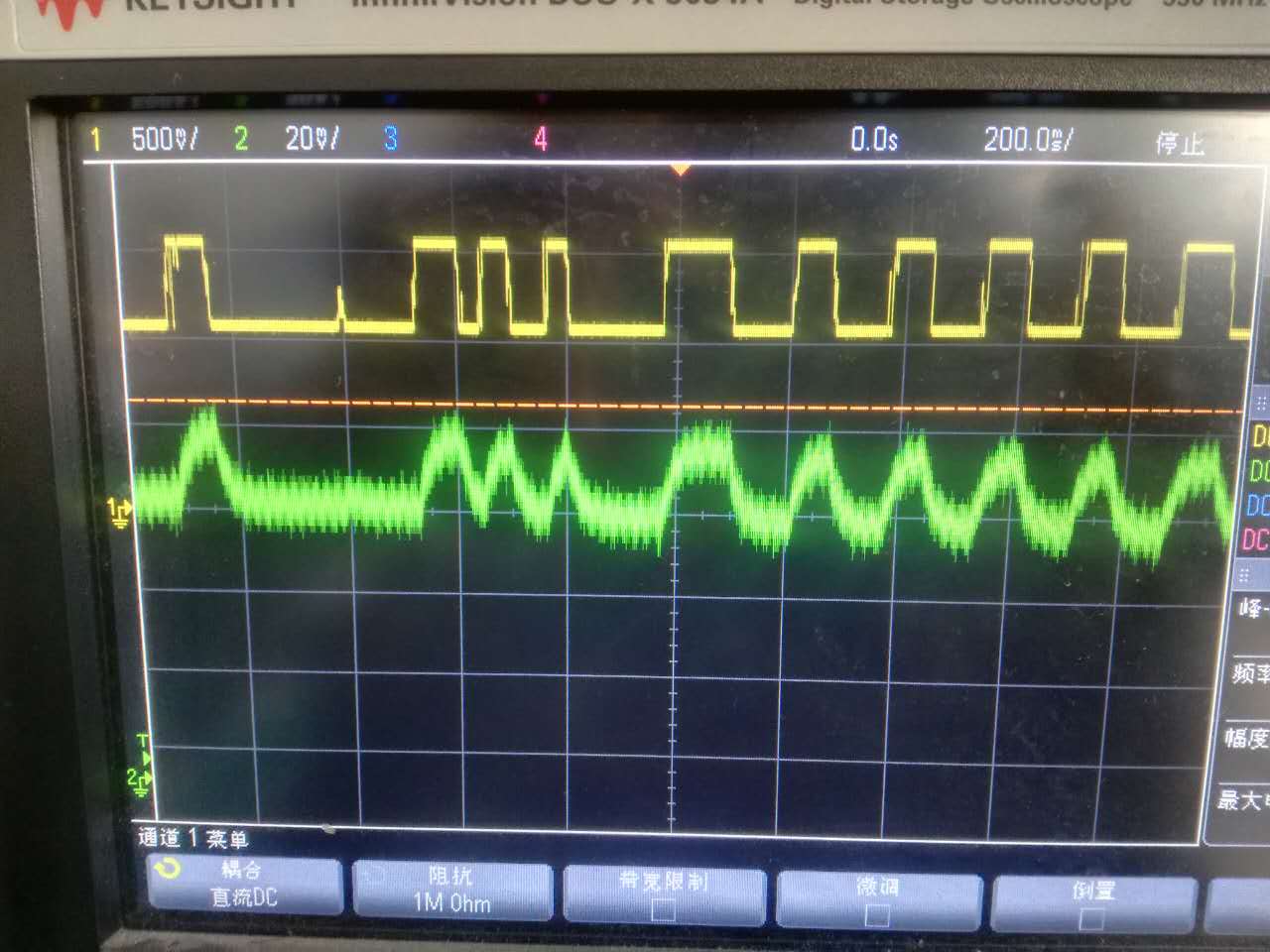

    I also measured the input of IN2P(positive input of channle 2 ) and the input of IN1N(negtive input of channel 1) without the ECG connector plugged. see the figure below.(yellow one is the input of channel 2)

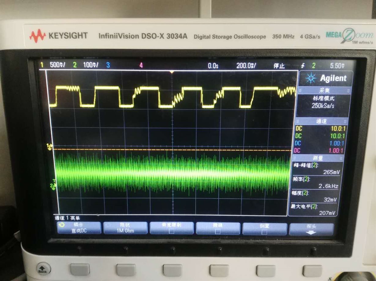

    When I plugged the ECG wires to channle 1, I repeated the measurement. See the figure below.(yeloow one is the input of channel 2)
    I do not know how the input of channel 2 affects the input of channel 1 and why it disappeared after the ECG wire was connected to channel 1.

  • Hi Xianwen,
    Thank you for the additional detail!  I did not realize that you had 'open inputs' on the the ECG channel.  Generally speaking, having open analog inputs is not the best situation to have while performing measurements - you can get some cross coupling in that situation.  If you can try a little experiment for me and use an external pullup on the ECG channel, then re-run your pressure sensor test and see if the signal still couples through, I'd appreciate that.
  • Hi Tom
    I pulled up IN1P and IN1N to 3.3V, and the coupling disappeared. In open situation, it is still there.
