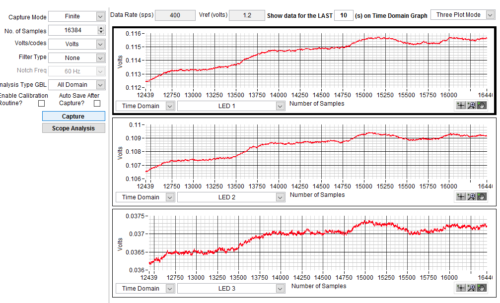

I am using an AFE4404 with the NJL5513R sensor to measure blood oxygen. When I am reading in the PPG wave, I usually get unreadable data. I am reading on the finger currently. Do anyone have suggestions on how to make this more clean data? Here is a picture of one of my readings.
Thank you!

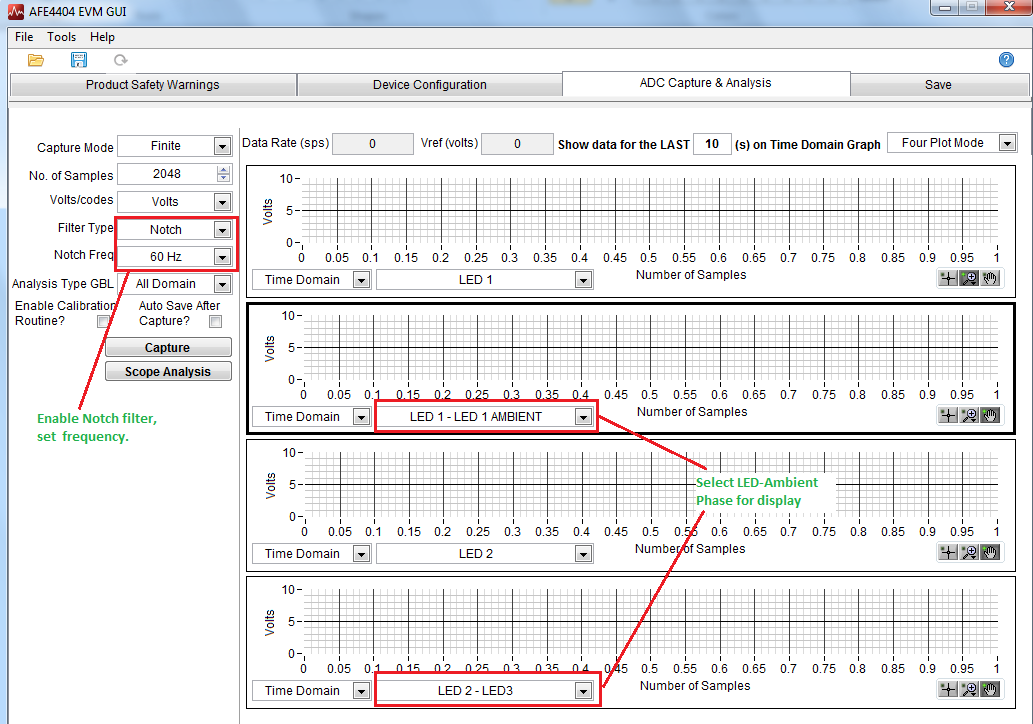

    Following are few things to consider to get clean PPG signal
    1) Avoid 50/60 Hz pickup: Run the EVM from Laptop with AC Mains unplugged.
    2) You can Enable 50/60 Hz Notch filter in the GUI to filter out any remaining noise.
    3) Instead of looking LED phase data, look for LED-Ambient data (i.e. "LED2-LED3" or "LED1-LED1 Ambient").
    Prabin
