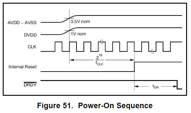

I am facing that DRDY is not output. I can not undetstand how is setting. please give me a advise.

    The ADS1282 /DRDY pin should toggle after power-on if a clock is applied and the device is not in power-down mode, as shown in figure 51:
    Note: The CLK signal should NOT be applied prior to power supplies as this figure shows.
    Check that your supply voltages are correct, the clock is present, and that the /PWDN and /RESET pins have been set high to begin the ADC conversions.

  • The supply voltage both AVDD and DVDD is 3.3V. The freqency of CLK is 3.84MHz, SCLK is 1.92MHz(equal to CLK/2). I wait 173ms (2^16/3.84Hz) after power on, and RESTE is applied Low value is kept 2clk as figure 51. But RDRY can not be Low. How is RDRY, if power on and clk is supplied at the same tme ?

    AVDD ought to be a 5V supply (minimum specification is 4.75 V). Try increasing the AVDD voltage.
    Additionally, the /RESET pin needs to be set high, otherwise the device will be held in the reset state. Note that the reset signal in figure 51 is an internal signal and not the same as the /RESET pin.
    With AVDD at 3.3V and /RESET low, the device will be held in a reset stare and you will not see /DRDY toggle.
