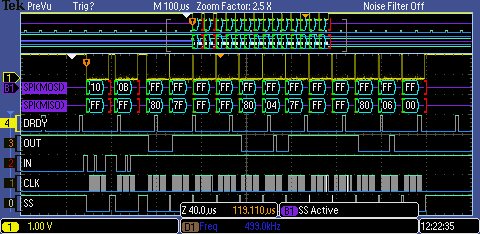

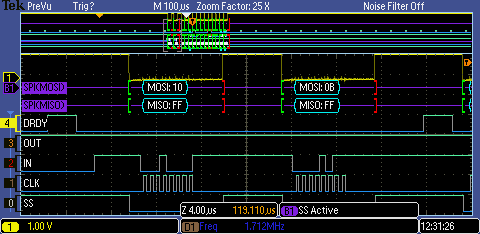

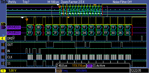

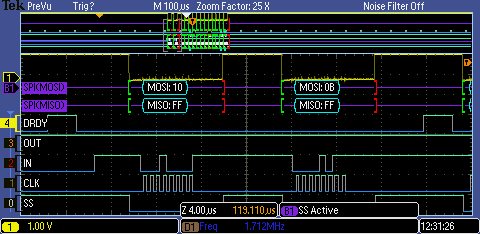

I'm trying to read the ADS1256 register's values - which seem not the correct values that I got. Could you help to look into it?

  • One other thing to check (brought up by my colleague Tom Hendrick) is the phase of the read and write.
    The data is read out and clocked in on the falling edge of SCLK. From your second picture, it looks like you have data clocking in on the rising edge of SCLK.
    Joseph Wu
    (Thanks Tom)

  • I would check your communications again. From your second scope photo, it looks like your DIN is being setup on the falling edge of SCLK for the ADS1256 to be latched in on the rising edge of SCLK.

  • Thank you Joseph, everything works now, and repeatable at 1.714MHz shift clock rate!
    One of the main issue was selecting the falling edge of SCLK at the SPI initial settings. I have to change it to rising edge of SCLK again.
    Appreciate your help, great work!
