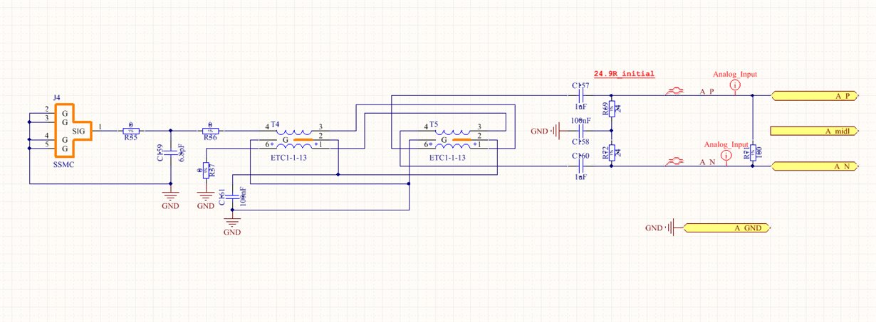

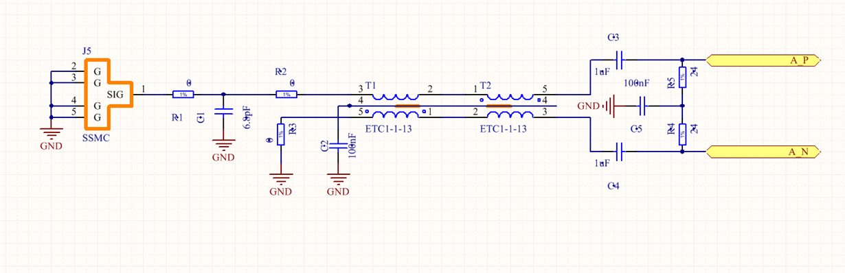

Hello.
In my board i use dual balun ETC1-1-13 identical matching circuit as EVM board for ADS5402 EVM.
Impedance matched to the load 50, but I see that input signal level decreases by 6 dB.
What could be the cause of the fall of the input signal level?
