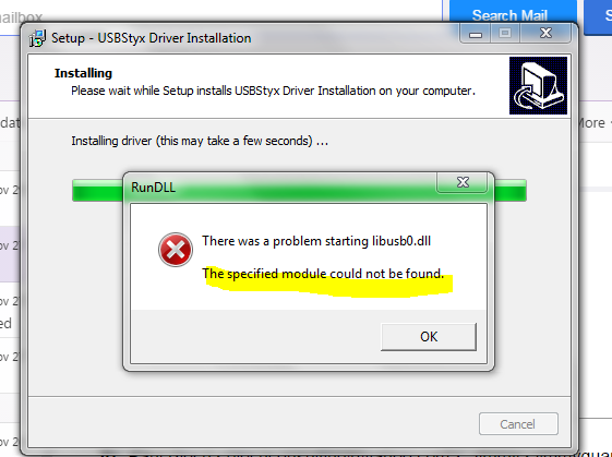

While trying to install the ADS8885 PDK for use with ADCPRO, I get an error regarding libusb0.dll, is there a recommended workaround or way to install this?
Hello Aaron,
Please try installing the mmb0 drivers using the link below. Please make sure you have administrator privileges on the PC before running the installer.
Please let me know if the issue persists.
Thanks and Best regards,
Luis
Hi Aaron,
Please find the updated/revised link; Please select the appropriate OS (32/64 bit) version of MMB0 driver installer.
ftp://ftp.ti.com/pub/data_acquisition/ADCPro2/misc/drivers/
Thanks and Regards,
Luis
